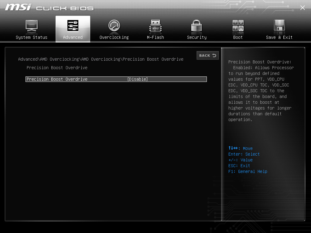

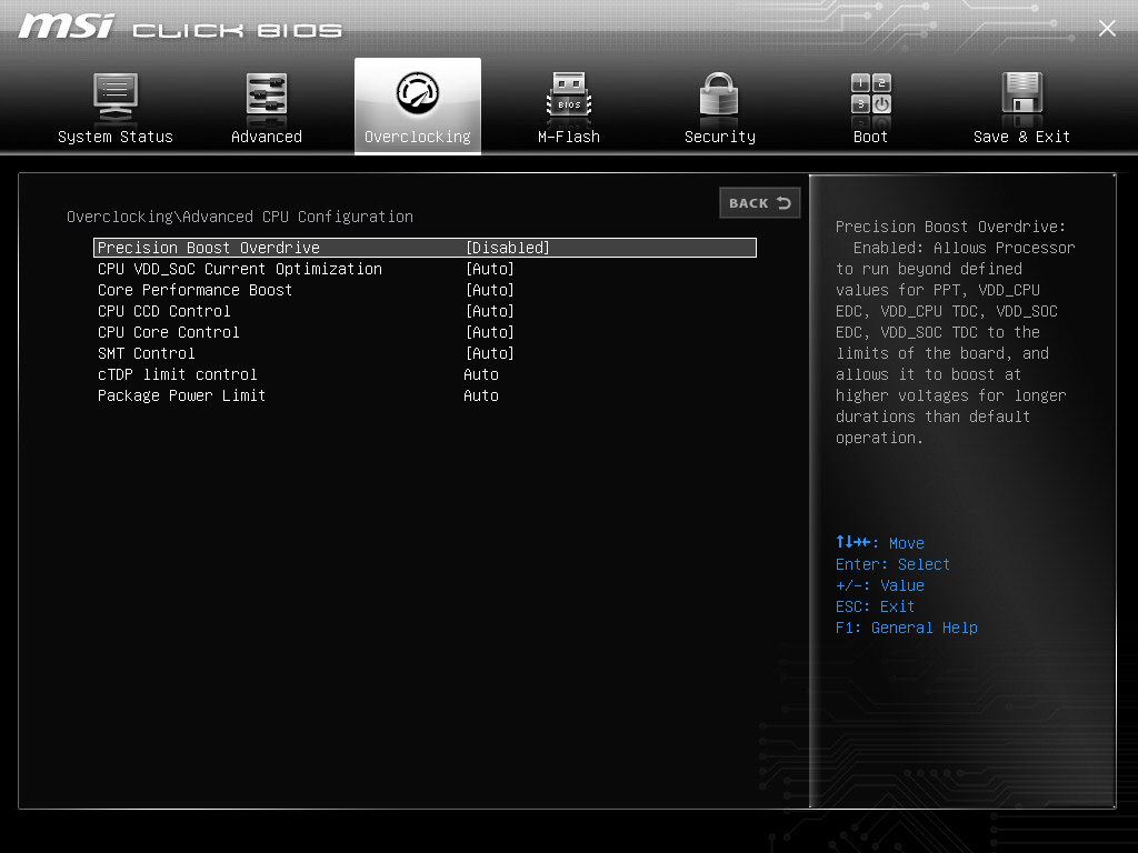

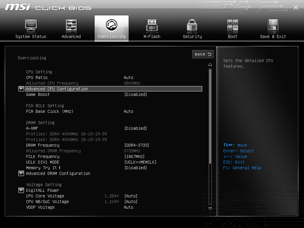

I do not want to make it more complicated for anyone.You did not mention some of things which may effect outcome.If post of the wall crazy or out of context for I can delete it no problem.
AMD Chipset driver version-newer versions missing /fazed out AMD Ryzen™ Power Saver Plan-Power plans can change behavior of voltages, I have seen as high as CPU 1.57 in idle/light loads without fixed voltage.
Which AGESA BIOS AMD ComboPI1.0.0.3,AMD ComboPI1.0.0.3AB,AMD ComboPI1.0.0.3ABB-Depending on BIOS there will be missing/added features So may not apply to most people.
CPU-Z along with Ryzen master to verify voltages not really needed or missing I guess.
Link to AMD Ryzen™ Power Saver Plan if any wants
Google drive AMD Ryzen™ Power Saver Plan and How to import power plan from desktop.
Open Command Prompt as(Admin)- powercfg -import “Full path of .pow file”
So from desktop command will look like - powercfg -import "C:\Users\YourName\AMD Ryzen™ Power Saver.pow"
https://drive.google.com/file/d/1nXzg4CgLUoA-141QiQ0TdKL3WZ01putS/view?usp=sharing

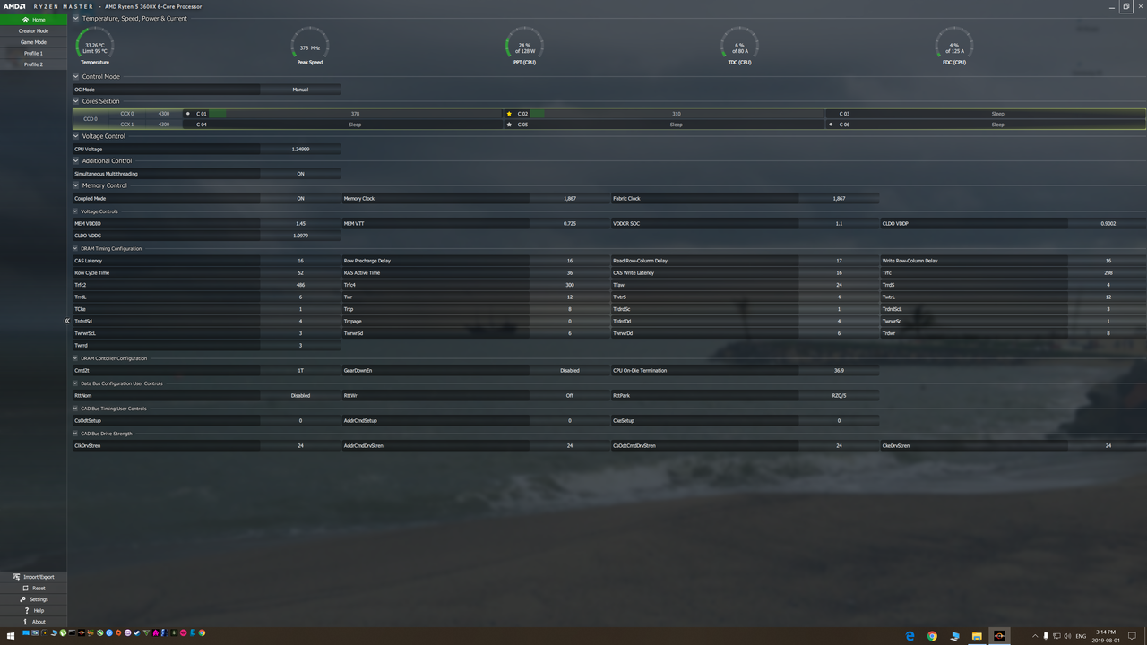

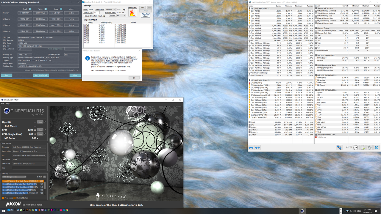

I played with it around July 12 2019 and tested for stability all was fine.Tested Intel Burn Test/Cinebench today and Video encode for an hour and seems fine.
Just installed Ryzen Master and all seems fine.Low temperatures and clocks all sleepy CCX and response on desktop is fine(snappy as usual)
No change from July 12 Ryzen Master ALL Core to Aug 1 2019 BIOS AMD Overclock-July 12 2019 Cinebench score was recorded with screen recording on ,which gives a slight disadvantage. Interpret as you want.
July 12 2019 Ryzen Master All Core Overclock 4300Mhz@CPU 1.35
JAug 1 2019 BIOS AMD Overclock 4300Mhz@CPU 1.35
