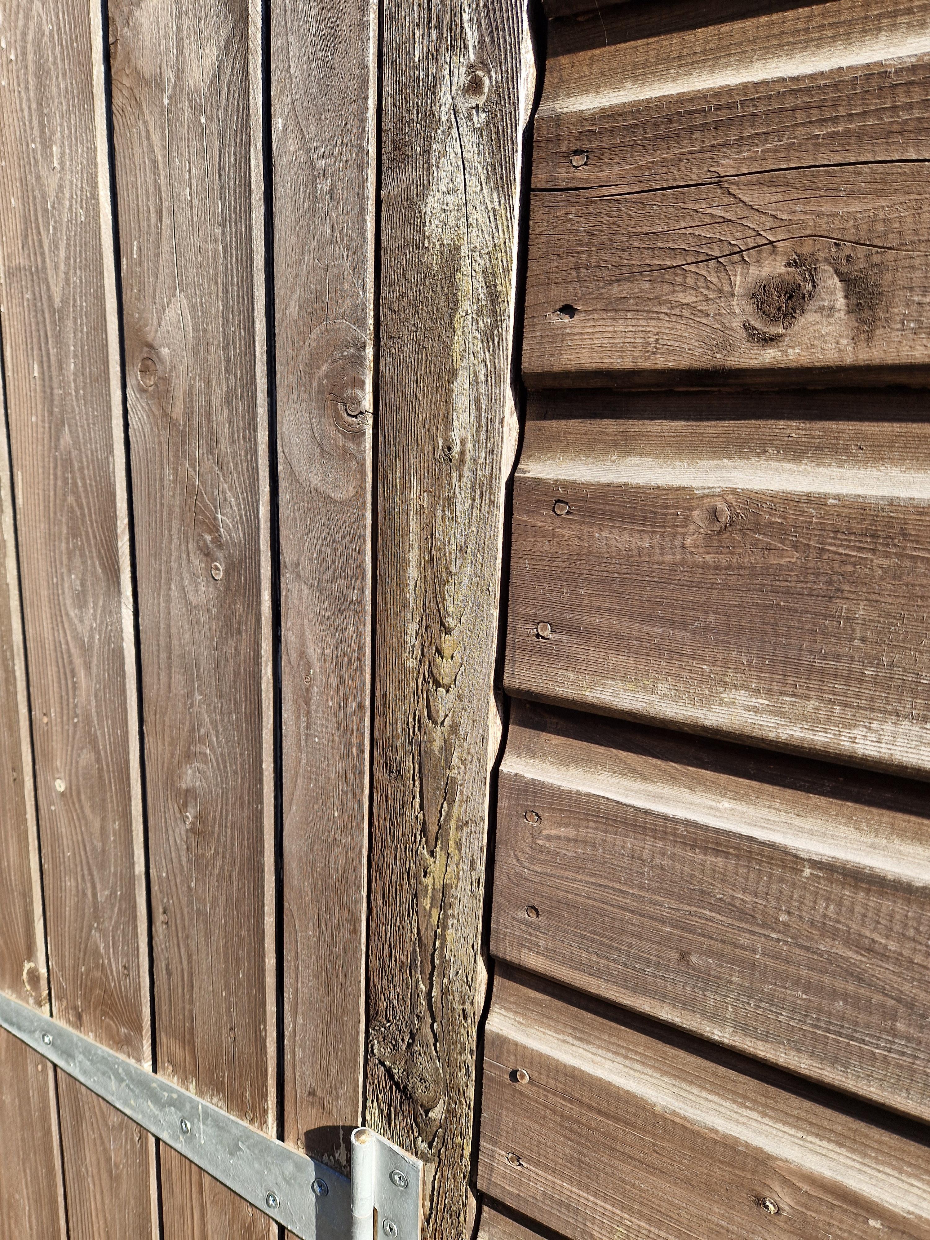

Here is a close up of the wood situation:
I think I might need some wood restorer to go on first? And then potentially something like the Cuprinol colours stuff?

Yea i would just touch it up a bit. Sheds are meant to take a beating and even so, they last years. I would be worried if i ever saw someone with a fresh clean looking shed lol.

To be honest I've probably over egged wire brushing. I'll post a gif later to show how easy all that brown stuff came off.I don't think you need to go to the hassle of wire brushing it. The colour of the wood is just natural fading as opposed to damage. You should be able to just paint over the top of it.
Perhaps just a light brushing to remove any loose crap that is stuck to the shed prior to painting is all that's needed
Brill cheers fella. I'll go light to avoid taking away material.The top one you have cleaned off the top surface grim/treatment etc and also removed the sun bleached wood hence you see more of a golden colour
The bottom really just the first part of above, some tiny patches of golden exposed
There is no point getting to the golden layer if you are intending to treat it well with anything but clear anyway
If your treatment is anything other than UV protecting your going to end up with wood like the bottom (cleaned) part anyway, as the sun will still bleach it
