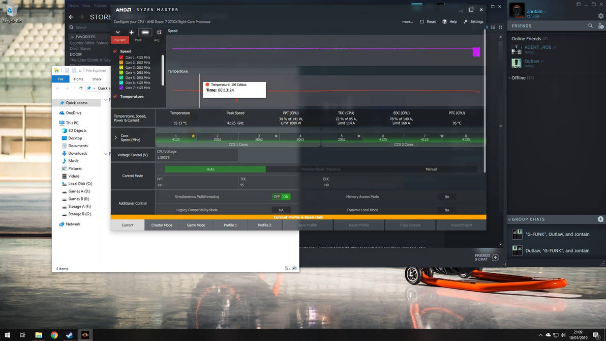

However I am wondering if this is down to my cpu giving the odd random temperature readings in error.
Running prime95 and monitoring in ryzen master I will get one second readings where it will either jump up (this evening's test gave a reading of 196c) or plummet down (-57c reading tonight) after which it goes back to where it seems to rest under load (about 68c).
Other monitoring software such as Cpuz and HWmonitor only detect these temps intermittently where as ryzen master seems to display the most unusual readings.
The cpu is at stock settings, the 8 pack ram that came with the bundle is at 3200 and I am using the stock wraith prism cooler. I am not sure if the cpu readings come from the cpu itself or from the mobo (x370-f again part of the bundle).

Case is vented at the top, pretty sure these temps aren't real readings, heres a couple of pics.

Seems like a defective sensor reading to me.. if the cpu actually hit 196c the CPU would most likely be dead if it hadn't already auto shutdown first also there is no way you will get to -68c without exotic cooling. My bet.. the sensor is simply tripping hard or you have something installed/running that interferes with the readings.

Through normal use and idle i do see the temps jumping around which sounds pretty normal for the Ryzen cpus as they try and make the most out of each core.
What is interesting is the anomalous readings always seem to be either -10, -57 or 196 from my testing. Generally when Ryzen Master detects one of these readings HWmonitor or CPUz won't detect it but I do remember a while back getting at least one of these programs to display one of these strange readings but didn't print screen.
Does anyone know if these temps are read by the cpu itself or does the mobo take the cpu readings?
Not sure if AMD offer any sort of warranty for this kind of issue or even if I should worry if since I have removed the Ai Suite software it doesn't (touch wood) seem to cause me any issues. It's just not very confidence inspiring not being able to find a single case of anyone else having this issue.
I should note I have only ever observed these issues whilst under load which I have mainly tested with Prime95, again not that it seems to effect the program in any way...

Ok running prime 95 and hwinfo pushed temps up to 84.9 where it came to a stop but stopped the test as only running stock cooler and I didn't want to leave it at that for long.
Still did have a -10 reading in ryzen master but only showing a min of 44.9 on cpu tctl and 34.9 on cpu tdie
Currently running heaven to see if I get and strange cpu readings...
