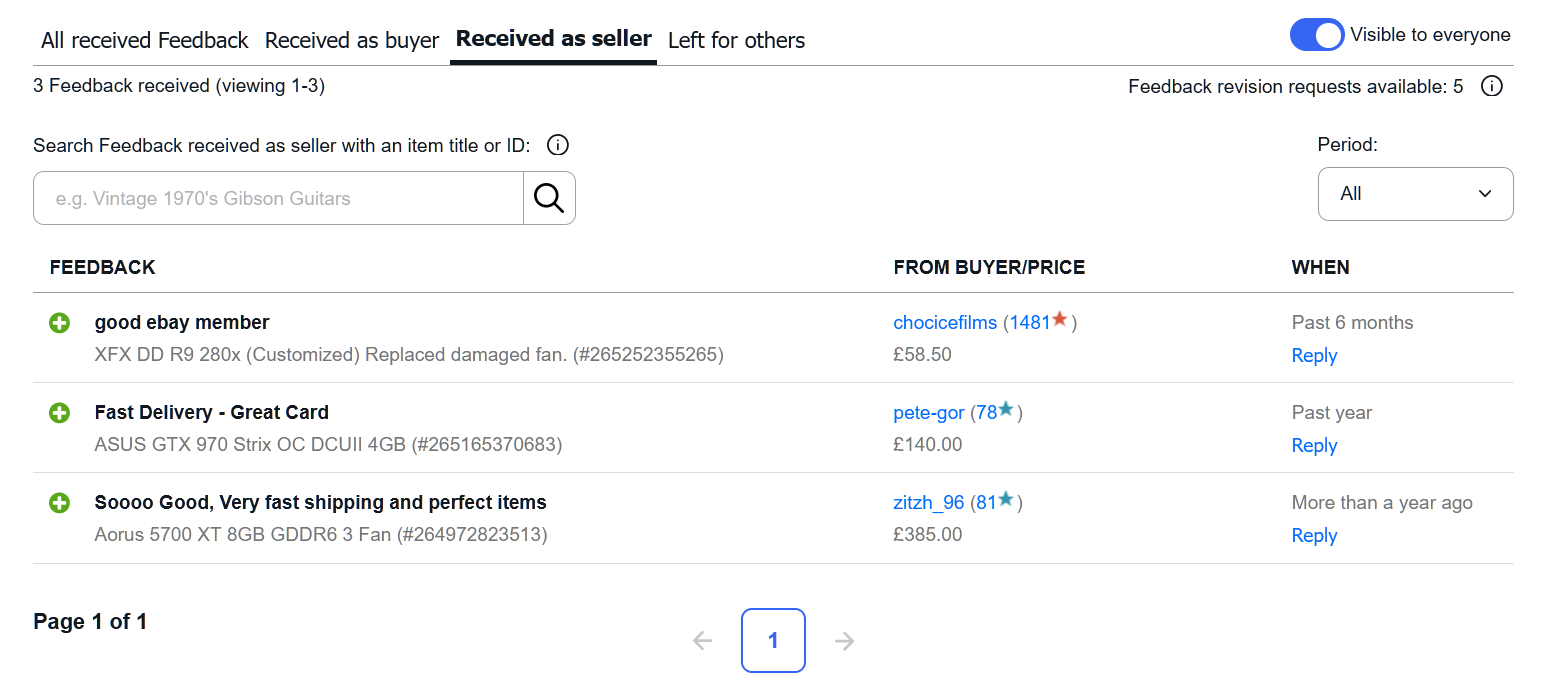

Here..
My Ebay says it was a satisfactory sale though.. amazing what AMD buyers will put up with whilst I am screaming along at seriously high FPS with zero issues.
Imagine getting immersed without worrying if something will break.. ahhh!
