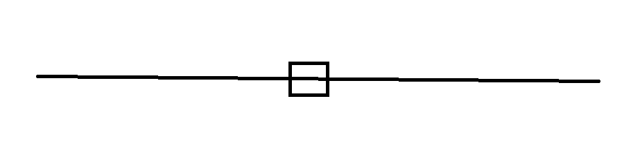

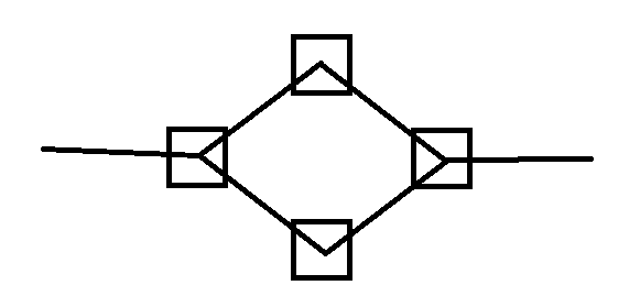

if you HAD to use two molex, would it work if you used a splitter to split one molex into two, then connected those two to one molex to 6 pin adapter?
No.
To put it in perspective, you're asking if this:
Is better than this:
