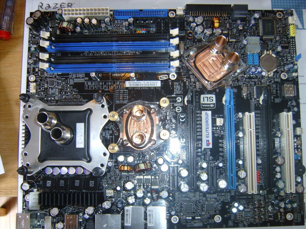

I'm looking at switching my machine over to watercooling. First going to start with just the Geforce 8800 GTX then move on from there, as I want to upgrade my motherboard before throwing any watercooling on it. I'm currently looking at the BFG nForce 680i, but was wondering about how to cool it.
I've noticed theres a DangerDen Chipset Block but I'm curious if anyone knows if it covers only the main chipset, or if it covers the whole thing? Also, if it does only cover the main chipset, what do I do with the pipes running all over the place?
I guess what I'm asking is, is it possible to watercool the BFG properly, or would I be stuck with buying the Black Pearl?
You need to ditch the whole heatpipe. meaning you need to cool what is left naked.
You can get EK blocks that will fit on the chipset, mosfets and SB. A much nicer solution IMO.
DD680i on the NB
EK NF1.1 on the SB.
That heatsink below all those R50s in the picture, I see thats being cooled in the Black Pearl edition. Is that important? Whats actually going on there that needs a heatsink? Never seen anything in that position before.
That's the power modulation circuitry, it does get hot, but unless you're pushing fairly large overclocks they'll be happy enough as they are.

On a 680i chipset board you will probably need some form of cooling on the PWM's as they get pretty darn hot! I saw mine reach 115c before I modded the stock heatsink on my IN9-32X MAX. I would not like to see how hot they get with no heatsink!!
