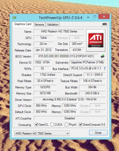

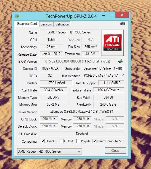

just some info that the bios' are different.
No Boost
Boost
