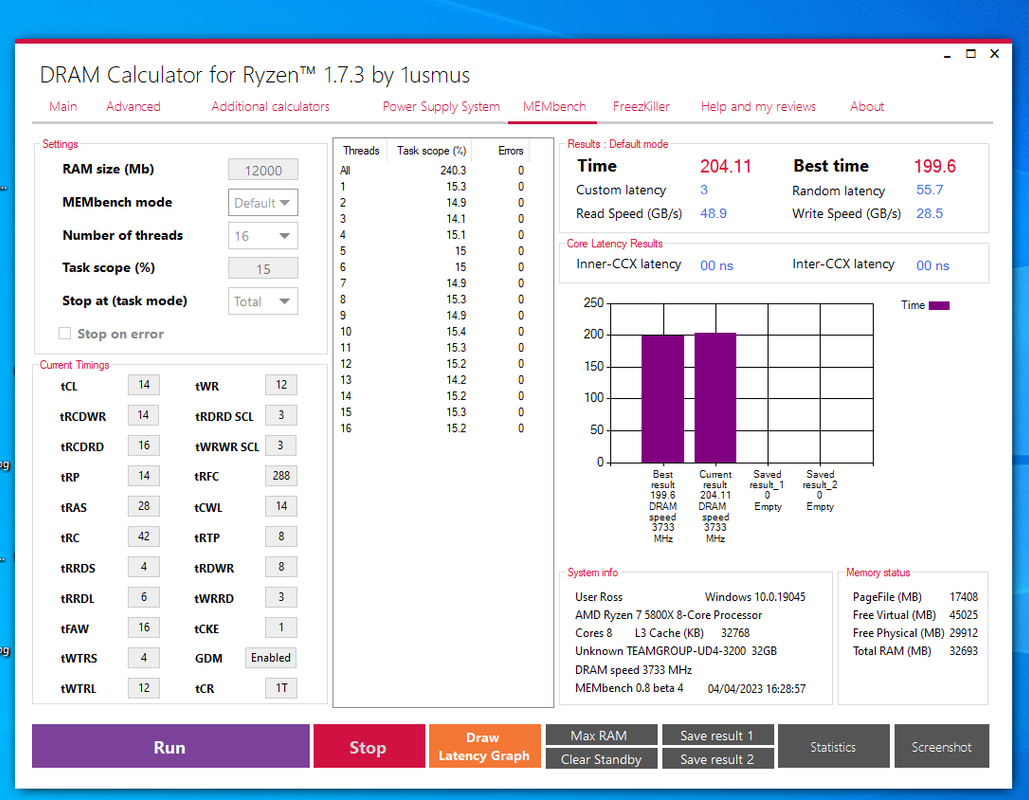

Just not having much luck getting stable, but also do not want to exceed 1.5v. Edit, I tried Guest2's settings with slightly higher voltages, still getting errors:Images aren't showing
I have this 32GB kit @ 1.4v 3800MT/s cl16. I have ProcODT 53.3ohms which is what made the difference for me. I went through this guide before:I've just moved from the 16gb kit that would happily sit at 3800 cass 14 at 1.40v to the 32gb kit.
Unfortunately the new kit won't even post at 3800 cas 16 and I've tried voltage upto 1.45.
Also tried 3600 14/14/34 but that doesnt pass memtest and blue screened the pc so at the moment I have it running at xmp.
No direct cooling on the RAM, but got a meshify c with x2 140mm front intake, 120mm bottom intake, 240mm aio top exhaust and 120mm rear exhaust, should be enough airflow.Have u got any cooling on the RAM? What numbers are you getting with DRAM calculator for Ryzen 1.7.3?
