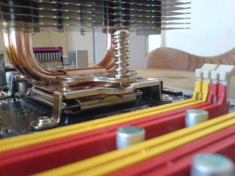

Im trying to attach my heatsink (Noctua) to the mobo and I have screwed in the backplate and the mounting bracket as well as the fastening brackets. When I try to screw the fastening brackets to the mounting brackets the screw & spring doesnt seem long enough to get through the fastening bracket to the mounting bracket, theres about a 3mm clearance between them. The screw will get through without the spring attached but that won't secure the heatsink. It seems that the CPU is too high or the mounting brackets are too low or the fastening bracket won't reach low enough.
What am I doing wrong?
Heres some pics of what I mean
