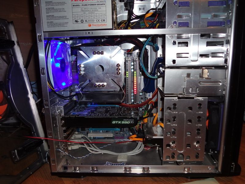

Here are a couple pictures to show the layout of the CPU cooler and the cables in the case:
The side panel fan is right above the CPU cooler so that’s probably not doing a lot of good, I know the cabling isn't the best but hopefully it isn't causing air flow issues?

tbh the cabling isn't to bad, you have the intake fan by the hard drive so if its pushing air in it should be supplying some decent cooler air to the cpu.
if that is the desk behind the pc where its normally put are you leaving space for the exhaust air to clear out the back, only needs to be about 6-7 inches.
