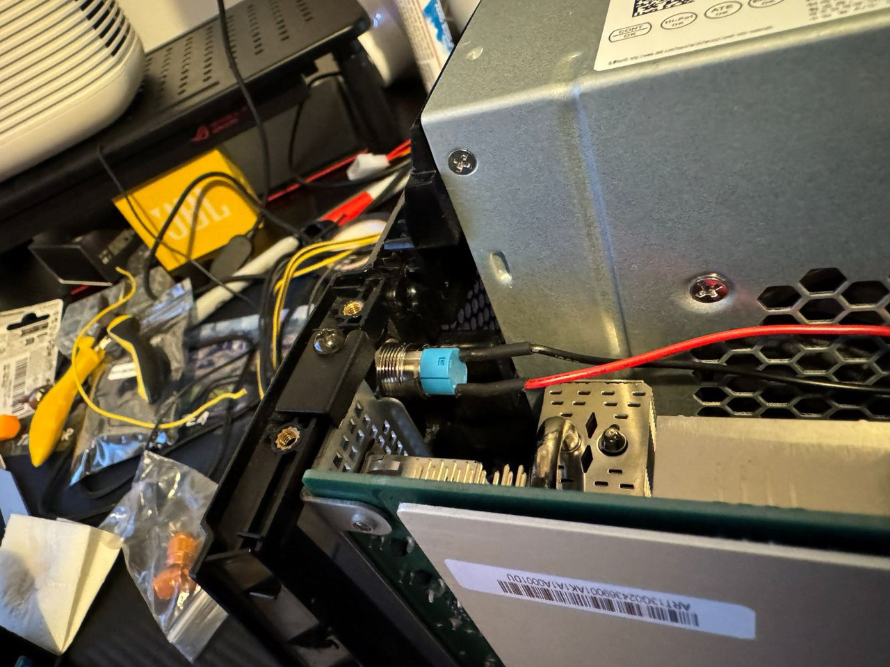

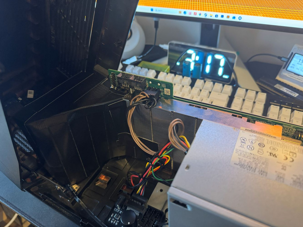

OK note. I used JB weld plastic bonder. It's like black epoxy. I could only use one bolt, as any more were not going into any metal and or would obscure it slotting into the PCIE tang.
The small slither is to be plastic welded to the end of the hole to stop it drifting outward. I will then fashion another bracket to hold it in at the other end. Probably tomorrow tbh, I don't forsee it being very hard.
OK so I put some spade connectors male and female on the power button wires. That worked. Time to boot it up and install Bazzite...

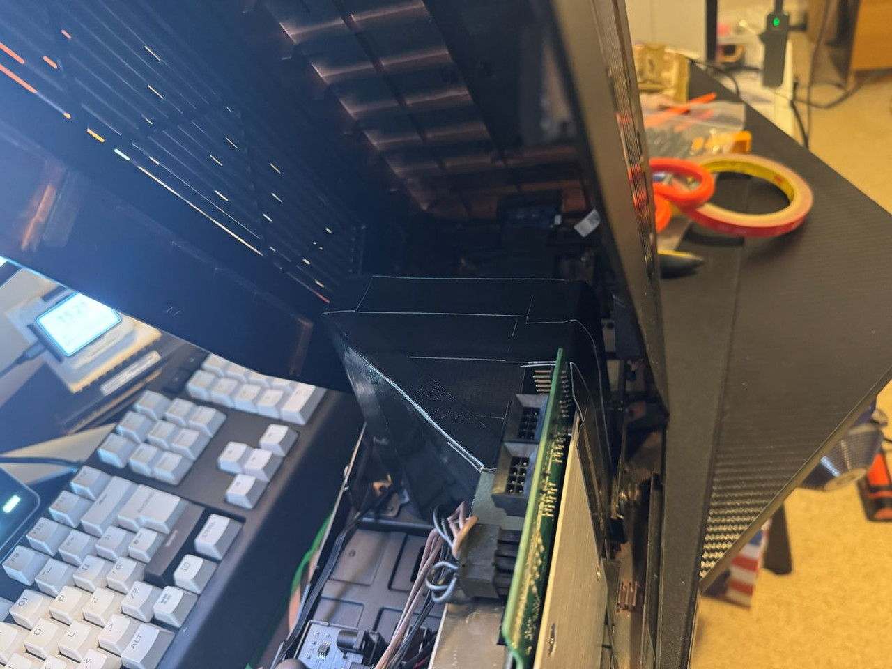

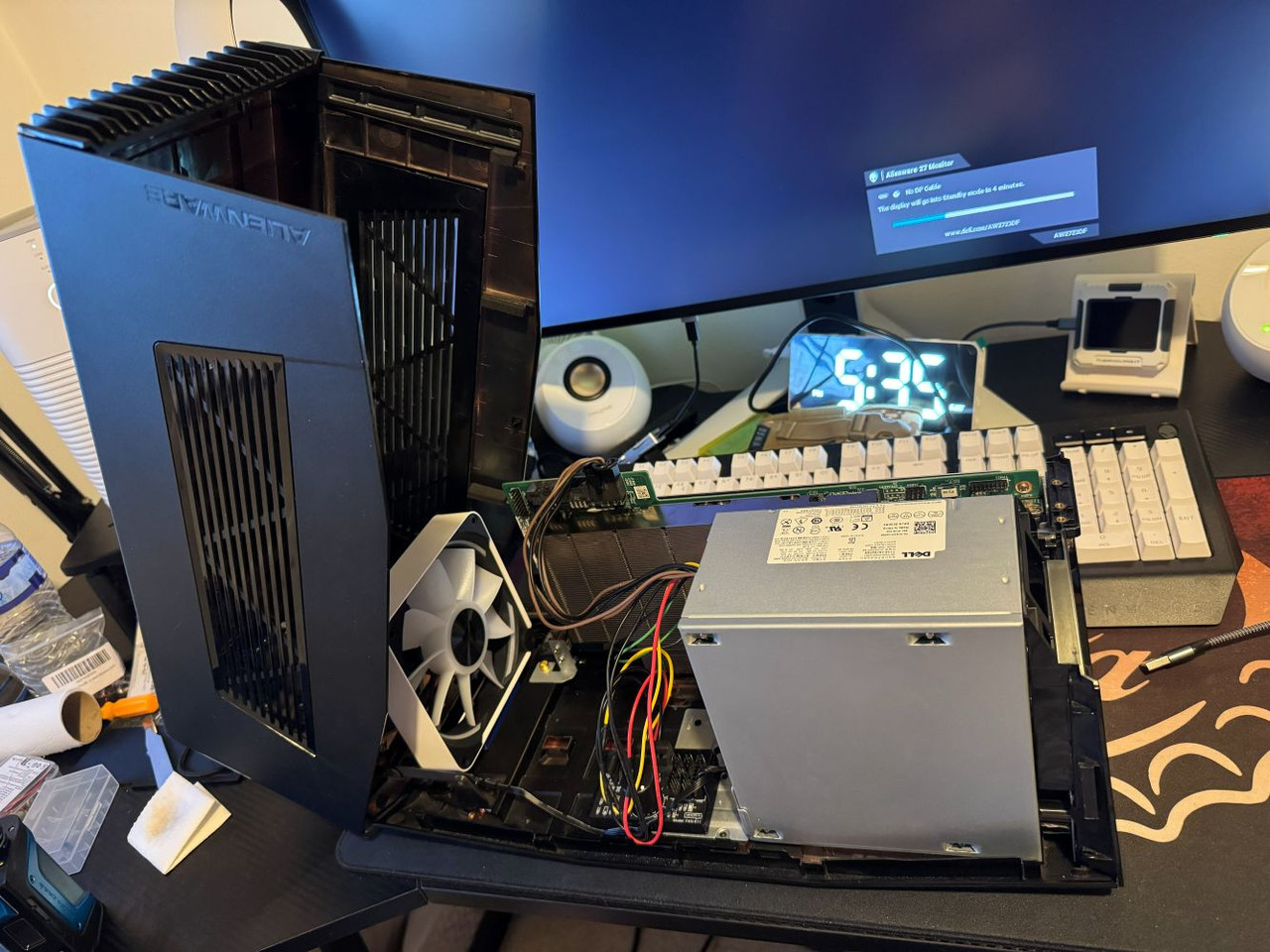

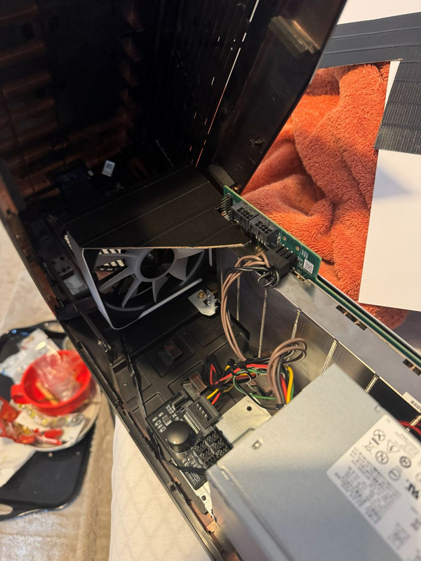

Those of you who had your money on that puny Noctua not being up to the task? were correct. So I machined two pieces of plastic, glued them to the floor then VHB a larger fan onto those.

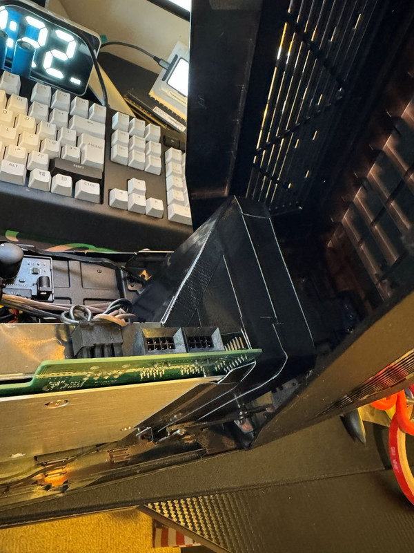

No duct yet, that will be the last task. I made up the small bracket I spoke of and fitted that.
Now I knew it wasn't going to close but it was annoying.

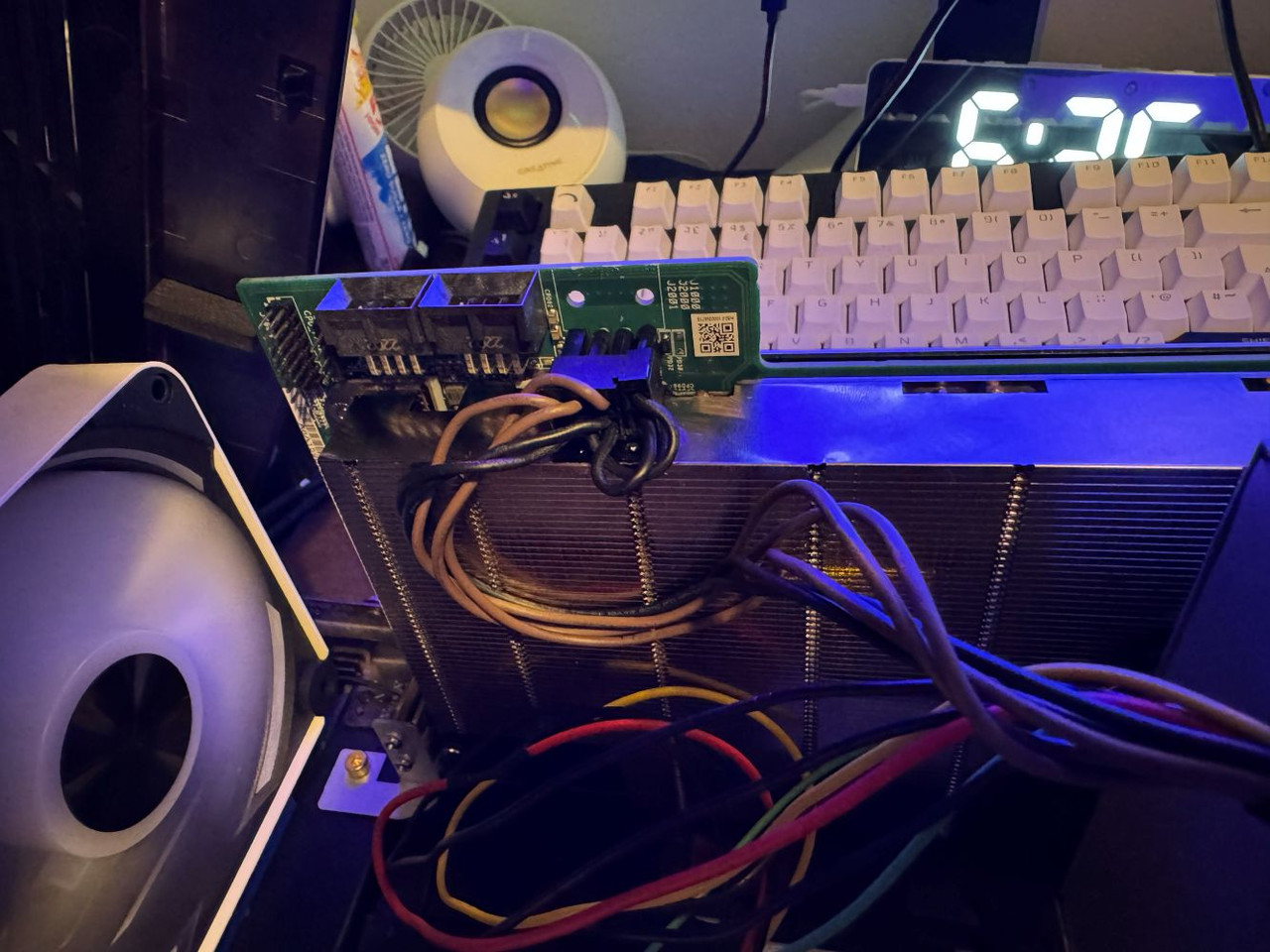

Now initially I tried to solder on a pigtail behind the connector. It did not work. I think the solder on the sockets is made from uranium tbh. It just smokes but doesn't melt. So I somewhat lost my excrement in frustration and well it now looks like this lmao.
*cut mangle snap etc*.
But it works, and I will take that.
Hehe. About a week for that.

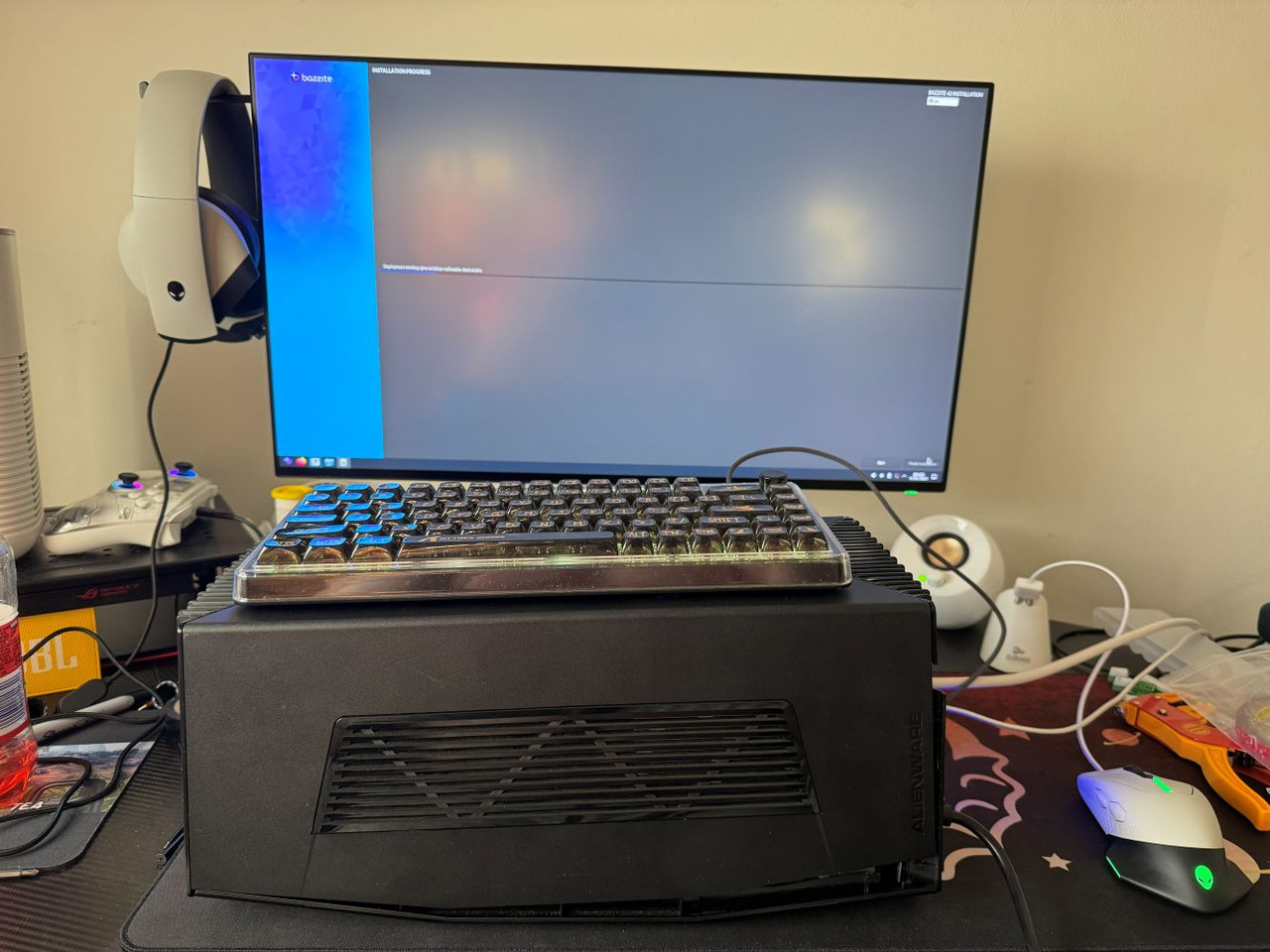

It’s basically done now, other than the led.
Update coming in later as I’ve just gotten home.
I’ll do the led and some tidying and cleaning when I get back.

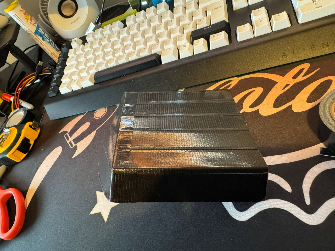

I have seen many people trying to cool these with all sorts of whacky crazy methods. Like hacking the top layer off of the large vapor chamber and so on. Why?. What was wrong with the initial idea of simply blowing air through the sodding thing?
As such I did not destroy mine as I totally didn't need to. The answer was incredibly simple. Grab a roll of Gorilla extra strong duct tape and a thin sheet of card. Then you simply wrap both sides and you get a very stiff yet flexible material to work with. Then? start off with a fan with smooth sides and simply VHB FTW.
Before fitting said VHB we remove and create the rest.
Before finally.
