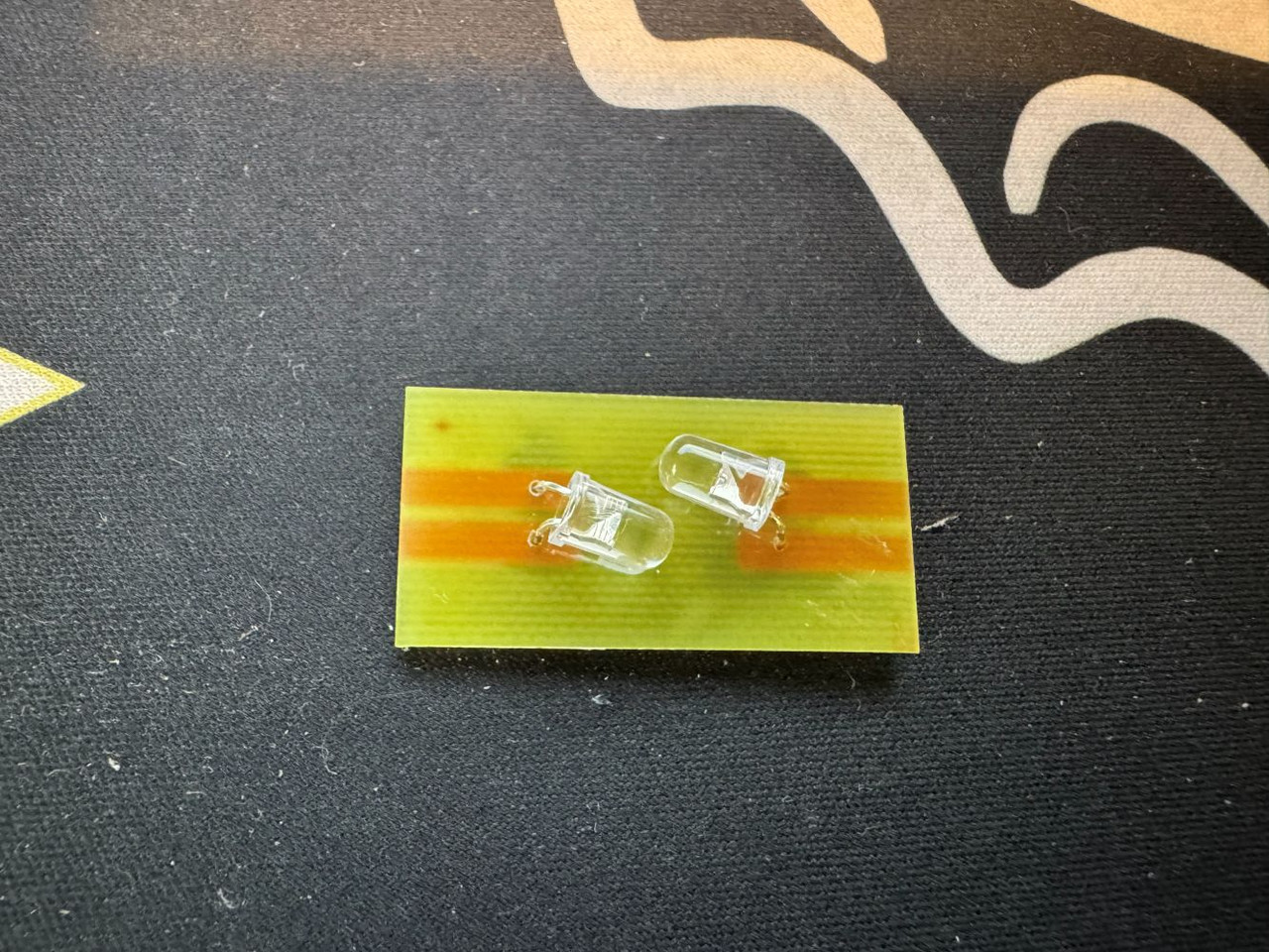

OK so it will be finished tomorrow 100%. I bonded in some supports to stop the unit moving sideways at the IO. That is all finished now. I needed to file a bit too to make it close over the screw holding it in which is odd but ho hum.

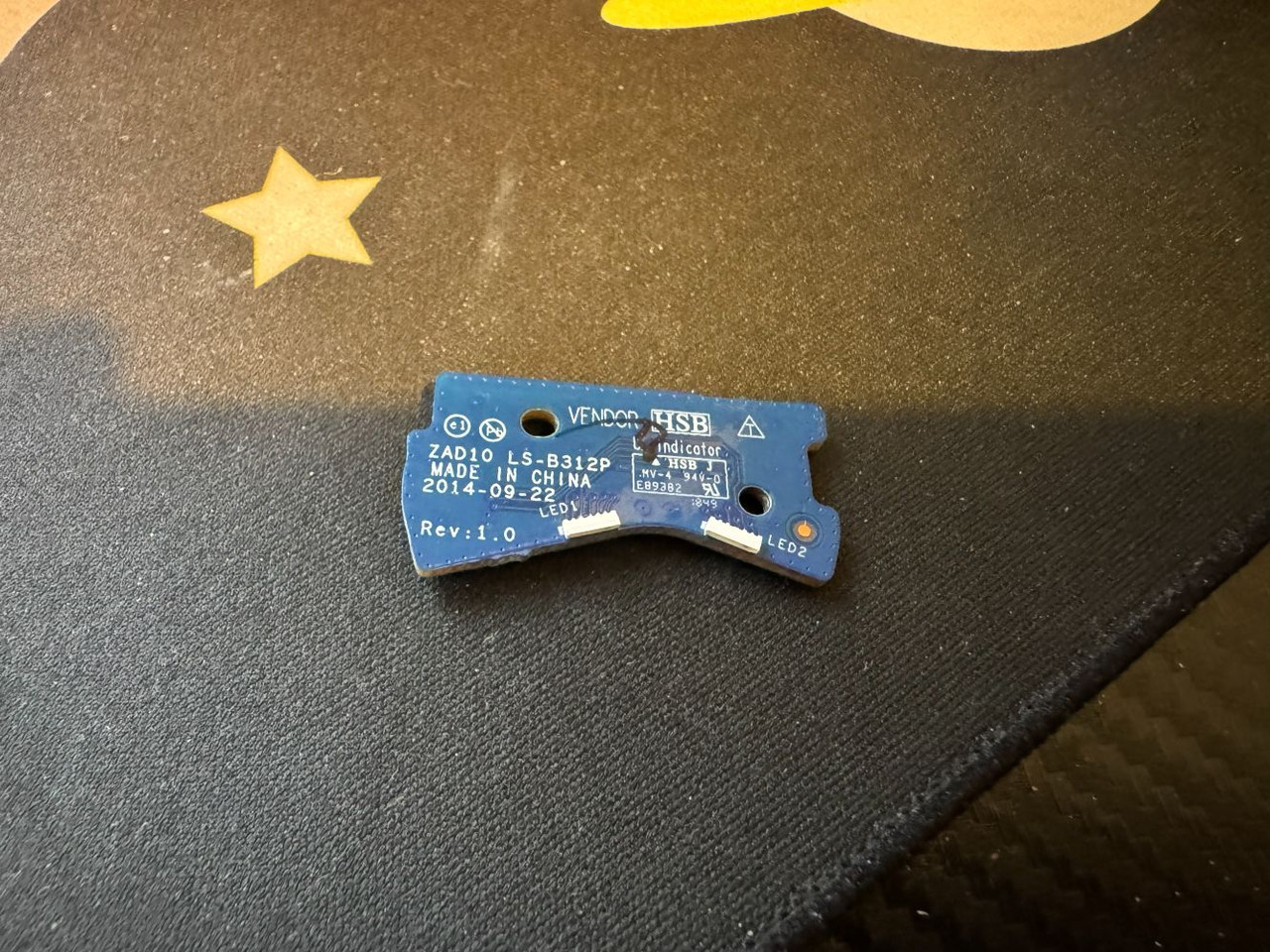

Today I took out the LED PCB. Not good news.

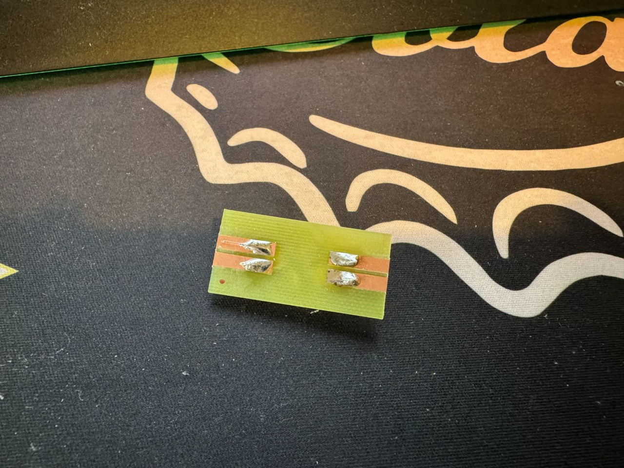

I can't replicate that so I need to make a light box that will be glued in. Will machine that tomorrow, but today I did some Fisher Price My First PCB (TM)
I'm trying....
