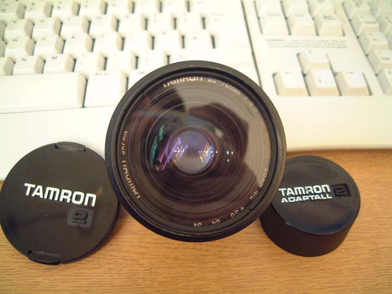

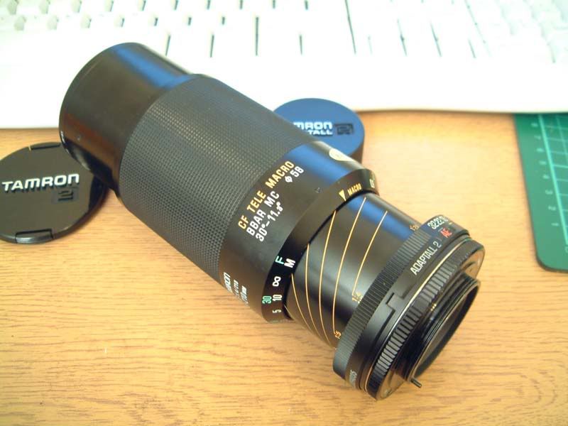

This is a Tamron lens. The info on it reads:
CF Tele Macro
BBAR MC 58
30'-11.3'
1 : 3.8 1:4/210
80-210mm

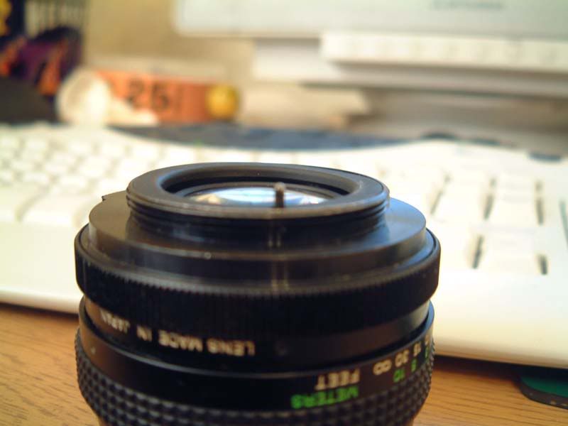

Another Tamron one:
7 elements in 7 groups
Angle of View: 64°-34°
Minimum Focusing Distance: 0.25 m (0.82 ft.)
Minimum Aperture: f/22
Filter Size: 58 mm
Lens Hood: screw-in (not included)
Weight: 340 g (with M42 adapter)

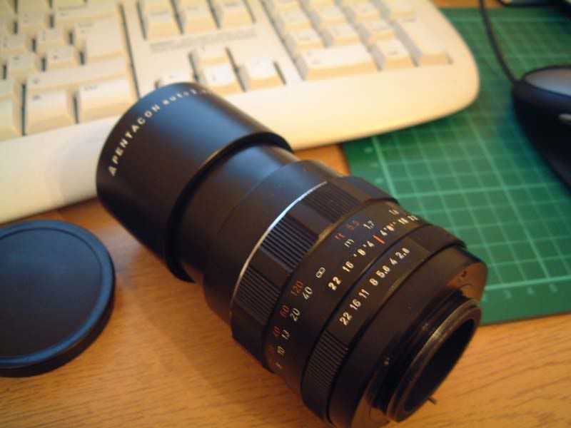

A Pentacon one:
Construction - 5 elements, 4 groups
Angular field - 18°
Minimum focusing distance - 1.5m (pre-set), 1.7 (auto)
Diaphragm action - Pre-set / Fully automatic
Minimum aperture - f/32 (pre-set), f/22 (auto)
Filter size - 55mm screw-in type
Push-on diameter - 57 (pre-set) / 60mm (auto)
Weight - 515g (pre-set), 470g (auto)
Barrel length - 94mm (pre-set), 89mm (auto)

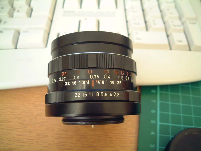

Another Pentacon:
Construction - 7 elements, 7 groups
Angular field - 73°
Minimum focusing distance - 0.25m
Diaphragm action - Fully automatic
Minimum aperture - f/22
Push-on diameter - 57mm
Weight - 240g (auto) / 220g (electric)
Barrel length - 52mm

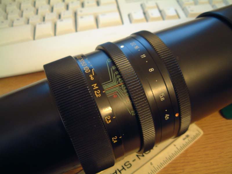

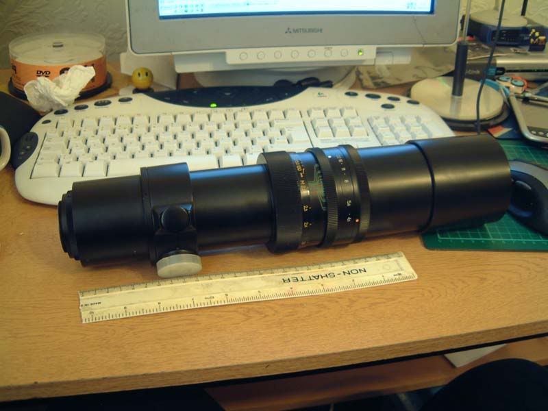

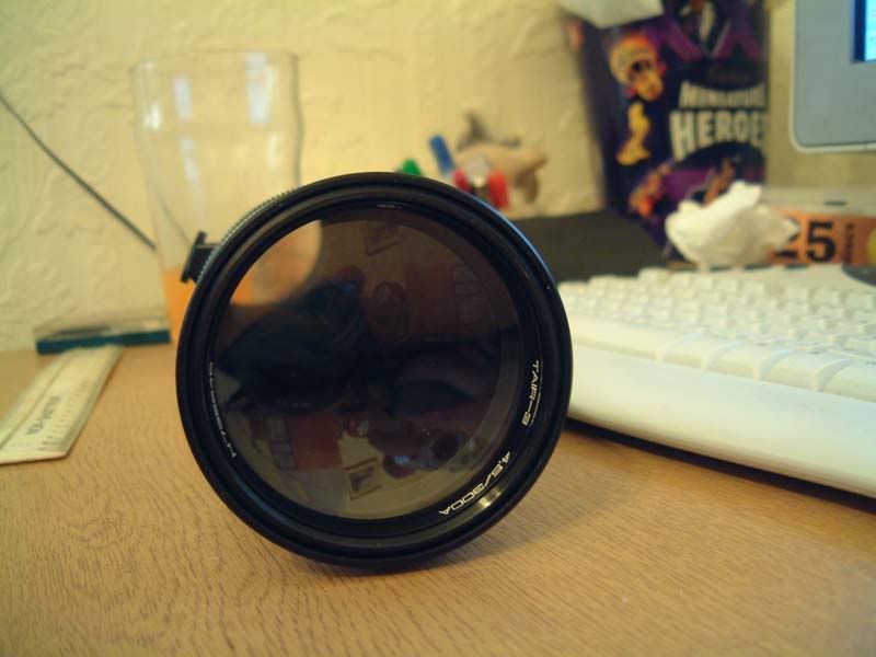

This is sat next to a 30cm ruler (ok, 26cm as 4cm snapped off, it didn't shatter as advertised though :p). Damn heavy!
It's Russian built, I couldn't find much from a google except in Russian. It has on it, Tair-3, 4.5/300a. Having tried it through an old SLR it magnifies a house up the road quite well.

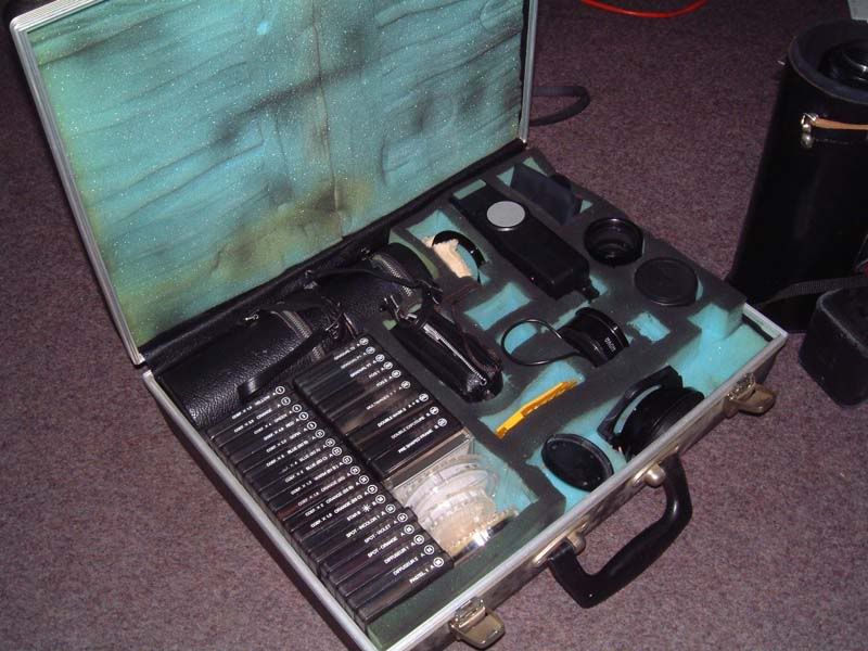

Theirs also a box full of stuff, including some old school light meter and loads of filters, a couple of zooming things / micro things (for want of a better word). Theirs some more stuff in other boxes too but these looked the most interesting.
All of them connect with this style ring, it's around 4cm diameter and, I think this is what my dad said, has a 'bayonett' fitting (the little metal prong).

Don't forget that the giant Russian thing will (as with all the lenses) be magnified further by the crop factor of your dSLR - should be able to get some seriously voyeuristic shots with that :D
There's a bunch of Cokin filter gear in the "box of stuff" - impossible to make out what filters on the supplied image, but there's bound to be some handy ones in there. Even if you find that these lenses aren't much cop (or are too hard for you to use) keep the Cokin filters - they will still have application with newer lenses.
Unfortunately, most of those lenses simply wont work with whatever new camera you get :(
Even with the adapter ring, the way the aperture is set just before shutter release is done by a mechanism inside the camera pushing on that little prong out the back.
If any of them have a swich on them to put them into "manual" mode then they can be used.
thats a nice set of lenses. not sure where you got the info from though as some of it doesnt sound quite right.(auto aperture on a fully manual lens)
they look like they're M42 screw mount, not bayonett. so you will need the relevant adapter ring (about £12 if you can find it in a camera shop).
Oh, damn. I think theirs 1 or 2 which have the manual thing on, the big Russian thing seems to too :o.
Mostly from Googling the info found on the camera (and google image search usually backed me up).
Thanks for pointing out the propper name, I'll have a look into that.
Thinking about the aperture problem, could you not buy an aperature ring, or I even read somewhere you can control the aperture electronically on the camera, would this not solve the lens problem to an extent?
