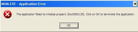

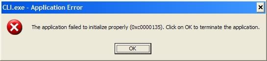

Iam having problems, installing the drivers. Ive tried both the 7.2 and 7.9 version and get this message each time I start windows xp and if I try to open catalyst control center.
The found new hardware wizard starts each time win boots aswell, but it can't find the drivers.
Try this & see what happens.
Run msconfig & go to the startup tab. Untick mom.exe.
Search for mom.exe on your HDD & delete it.
Reboot pc.
