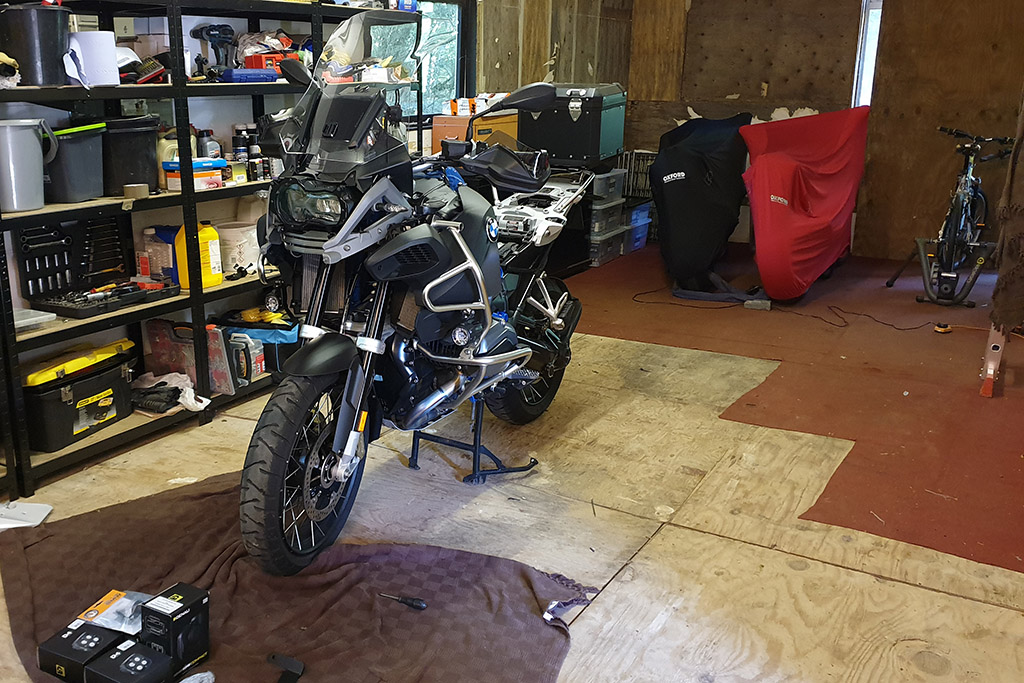

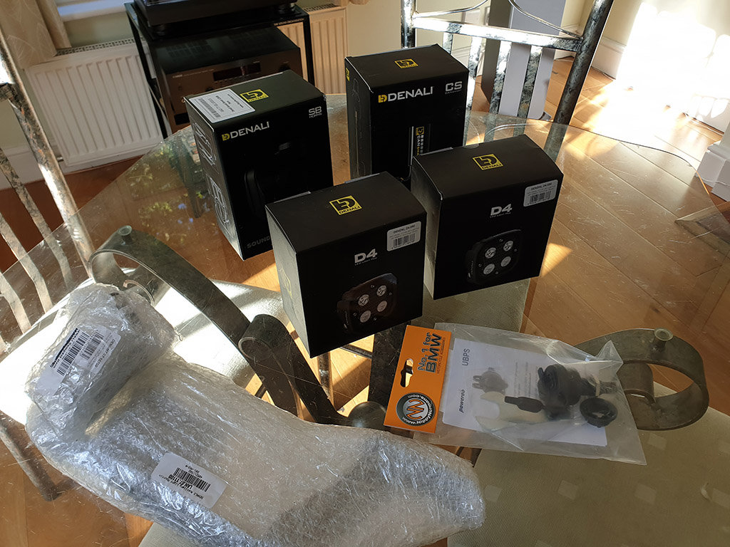

Denali kit turned up for my bike today, spent best part of the day installing it all. Most of the time was spent routing the cables and faffing about reinstalling the panels. Typically over engineered plastic German kit!
Pleased with results. Canbus control on the GS makes all the difference, using the BMW switchgear to control everything, rather than aftermarket switches bolted to the handlebars.
Box of goodies from Nippy Normans..
Lots of boxes!
Strip down to fit..
Lights and bracket installed

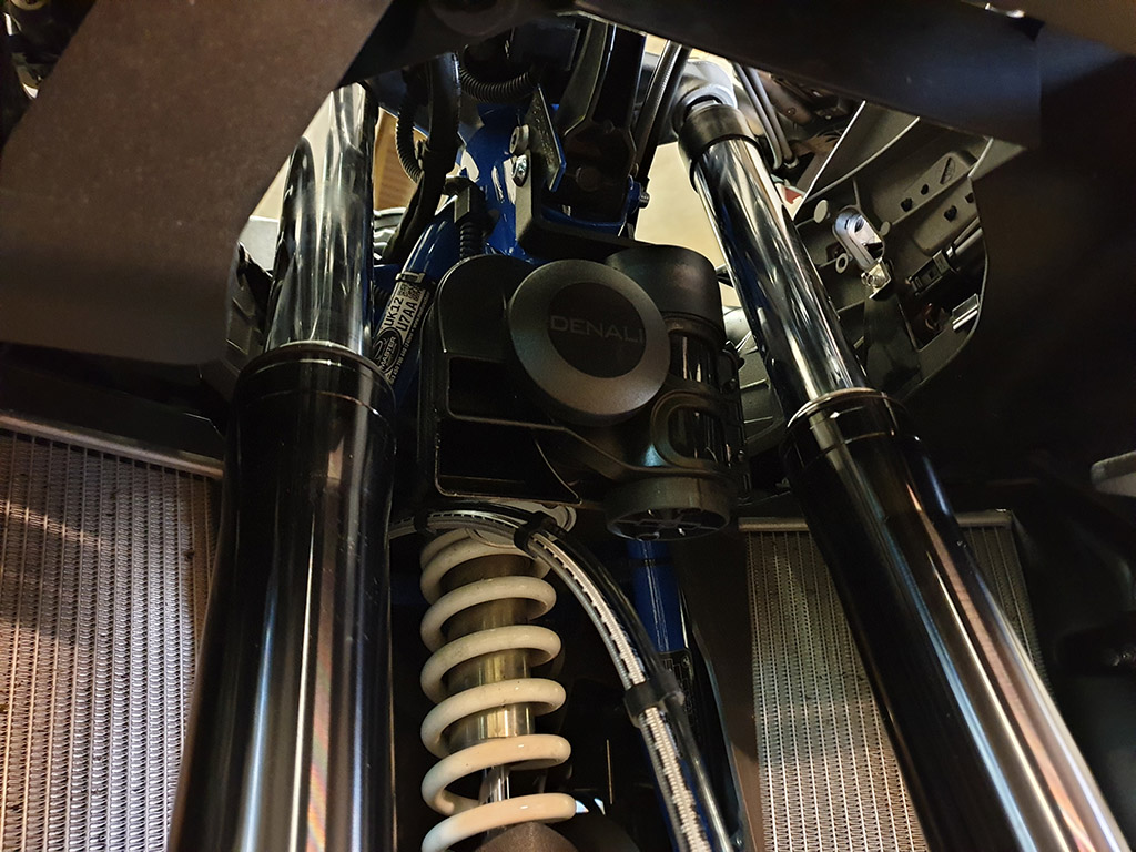

Soundbomb next..

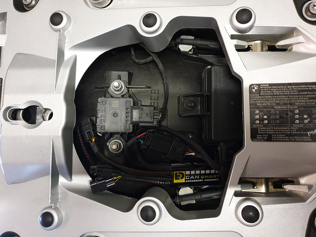

Then the CanSmart controller, the thing is tiny

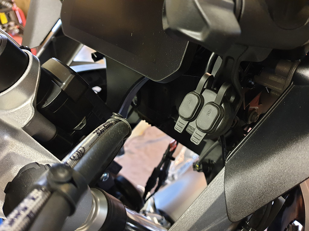

Whilst it's stripped, swap out the DIN socket for a dual USB
