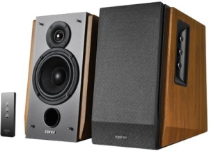

Yeah, there are a few versions of the R1600T's..
I have the R1600T+
The newer ones are angled, and look quite different:
Mine are OK, but not as good as the bookshelfs I demo'd, and being honest they've never sounded amazing, but I think that's me, I ended up putting them in the kitchen purely because they really don't sound good when turned up and just don't sound exciting, but that's coming from someone that enjoyed the corsair SP2500's..
