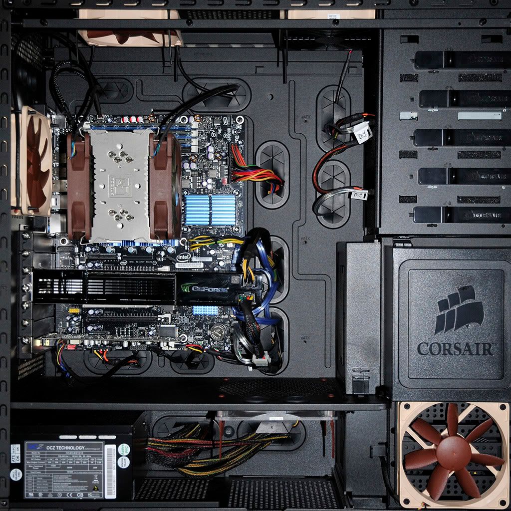

I replaced two of Corsair's 14 cm fans and have a 12 cm Noctua NF-P12 as rear exhaust and an Akasa 14 cm on the intake (slightly higher airflow than the stock fan). On top I added a 12 cm Noctua NF-S12B FLX as an exhaust on the furthest back vent. Another Noctua NF-P12 pulls air in from outside on the top middle vent (with a dust filter). The latter I found helps to cool the NB and extra air for the CPU cooler and graphics card.
CPU Cooler is a Noctua NH-U12 with two Akasa Apache fans in push-pull config. I have these under system control (PWM) and yet to see them go above 500 rpm while load temps on my i7 950 have yet to exceed 60. Took a bit of tinkering and trying various configs but this one seemed to work out as the most efficient. Should add that I'm using both the main and lower drive bays. I used a 12 cm Noctua NF-S12B ULN for the bottom bay. Both fans are on ultra-low noise resistors. No sense running these fans at high speed provided they move a little air over the drives. I have a photo which I will post when I get in from work.

I see you are considering the H5O. Most folks with that cooler tend to run with more exhaust fans on top, since ideally you want to pull air in and push it over the rad according to Corsair. Obviously my own is tweaked for air cooling (although i'm open to suggestions on improving my own setup of course) and I tried two exhausts on top but did little for my particular system.

You'll see I've also used sound dampening blocks not only to qiuet the DVD drives, but to fill some of the dead space. There's a helluva lot of room in there, maybe too much!

There is a single VelociRaptor hiding in that lower bay. WD in their wisdom chose not to make the first gen drives backplane compatible. I had considered removing the 3.5" heatsink (which you can just make out in the pic) and mounting it in the isolated bay above. The lower fan is a Noctua ULN with the higher value resistor but it's probably still competing to some extent against the main intake. Your idea sounds like much less hassle with the added bonus of not wiping out the warranty on the drive.
Right now the main cooling issue is the dual graphics card throwing warm air out into the case. The 9800 GX2 is a pair of 8800's which run notoriously hot. Just waiting on NVIDIA to pull the finger out and release the Fermi cards which hopefully have moved to a smaller die fab and generate less heat.
