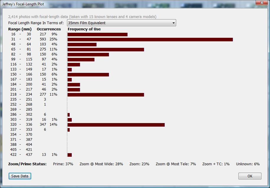

Love the graph! I'm gonna have a go now lol!
... How do you export the metadata though?
... Nevermind, I found a plugin
Here's my graph:
