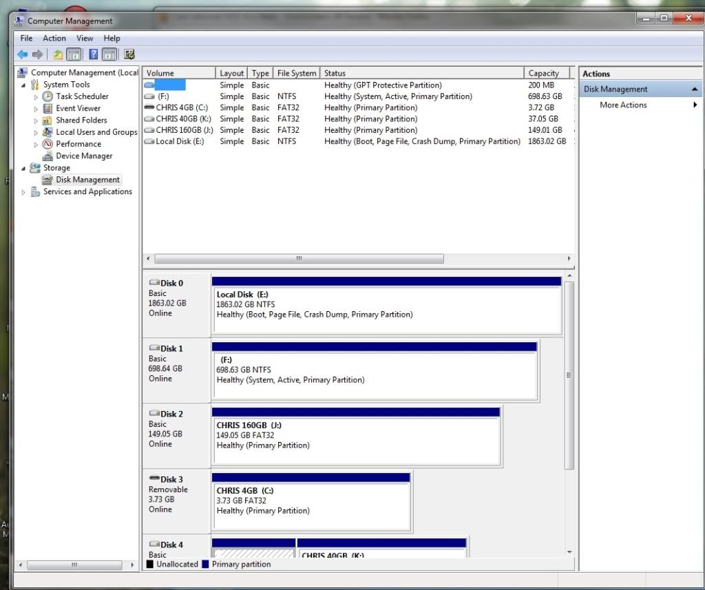

Post a screenshot of the Disk Management window then we can see what's going on. It may be that the system is actually booting from the drive you want to format. Windows won't allow you to format the partition which contains the boot files.

Did you dual boot at some point, hence have a windows install on the F: drive... it's seen in DM as a System disk....

OK, You can't format the F: drive because it's the system partition - ie the one the system boots from. You'll need to get the system booting from another disk before you can format f:
If I remember right you should be able to disconnect the F: drive entirely (at which point the system will fail to boot) and then boot from a Win 7 disk into the recovery console and add the boot files to the F: drive using the fixboot command. It's probably worth making sure that the F: drive is the only disk connected when you do this, that way you're sure that the boot files will go onto the right disk.
