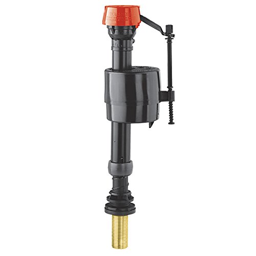

Throw away the ball and get this or similar.
Fluidmaster PRO45B
It comes with little white piece you put in the bottom if your water pressure is too high.

Combi isn't fitted yet, it's a older style toilet with overflow to outside, not to cistern.
Also older pipes not sure if they can take mains pressure.
