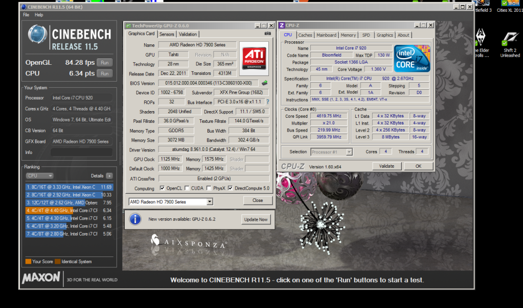

4.5ghz

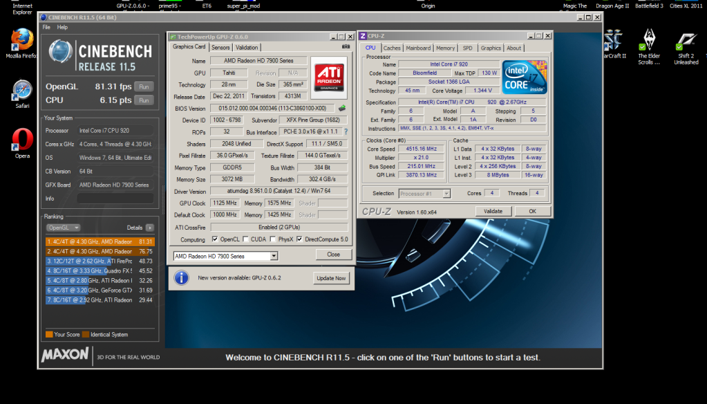

4.6ghz
At bang on 4.6Ghz my IB 3770K scores 9.35pts.

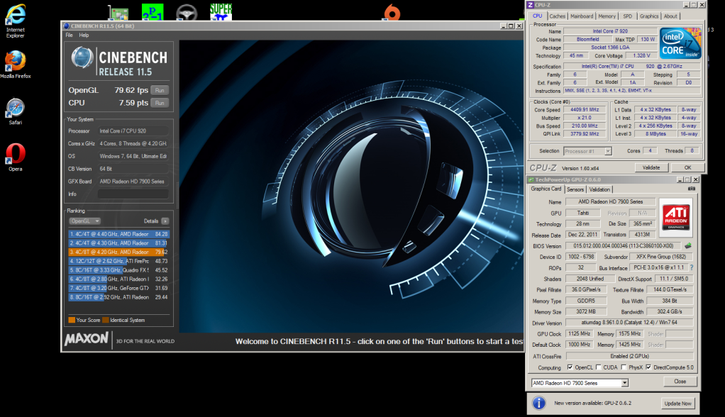

1.331v + LLC for 4.4ghz
1.375v + LLC for 4.5ghz
1.382v + LLC for 4.6ghz
MB is a gigabyte extreme with all the extra cooling on the chipsets plus waterblock (was £250 3 years ago). It was designed for heavy oc. Dont forget is a cherry picked cpu. My other i920 did 4ghz no LLC at 1.300v.
Thank you for uploading those results for me, zuludawn. I was curious to see how well it compares to an equally clocked Sandy Bridge system. The difference is quite intriguing.
Seems like Cinebench likes threads
4.4ghz HT on
4.5ghz Ht on
4.6 Ht on
Only ran half way then BSOD lol
