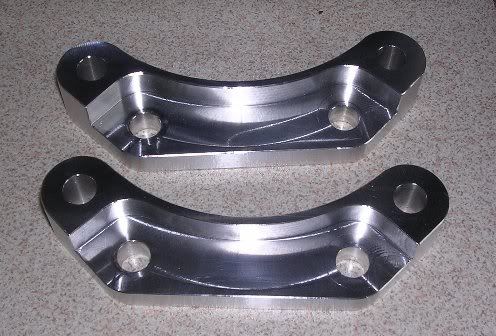

Hey, I like the idea of 285mm brakes on my clio so it will look better, perform better and be ready if i decide a 1.8 16v conversion.
Basically I'm going to get:
Renault 21 Turbo calipers
R21 TXi 285mm brake disks
Custom Bracket
Where could I get this bracket made cheaply though if that's possible
http://perso.wanadoo.fr/denisdup/images/PlanCale.jpg (plans)
Thanks.

I just need to know a few things. What does the bracket actually do? Will the calipers use the same bolts as the existing calipers?
List:
21 Turbo Calipers
Existing Bolts (?)
21 TXi Disks
21 Turbo Pads
These Brackets
What else will I be needing?
Cheers.
