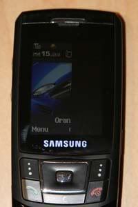

Basically I took my phone out of my pocket earlier and found that half of the screen has gone off totally, and the other half has dramatically reduced in quality.

Just posting because I know the D900 is supposed to have big problems with its screen, I think its mainly to do with cracking, but I thought someone might be able to tell me about it.

Happend on my e700.. kept doing what yours has done, then going back to normal. Eventually the whole screen stopped functioning...
Ive turned mine on and off a few times, had the battery in and out a few times and so far it has stayed like that, so totally useless basically, if I press hard on the screen then the dead side comes back slightly with stripes of the wallpaper but thats it :(

Yes, there is a very small gap between the outer lens and the LCD, loads of the LCDs are breaking. The demand for D900 LCD screens is huge , and has been for the last few months !
the screen loosing half the picture is a common problem with sammys that have sliders or flips, they all seem to have problems with the ribbon cable that connects the screen to the board, the only option is for new lcd with ribbon, then it depends on what the phone is if its worth buying the lcd or just getting a working one of the bay.
