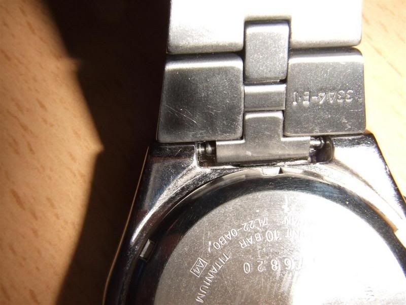

I went out the other weekend & took my watch off when I got in. In the morning I put it on and one of the sides of the bracelet was damaged. I've tried to illustrate it with trhe pictures below:-
This is the side that isn't damaged
This is the damaged side, you can sort of see how the pin is bent and there is more of a gap between the bracelet & the watch compared to the first picture.

Anyone know if this is fixable & roughly how much it would cost?
Cheers
Yes, just looks like you've just bent a small spring bar to me. Take it into any half decent jewellers and they should be able to replace it.
Cost? Couple of quid.
It's just a spring loaded pin that needs replacing by the looks of that. The part is cheap and can be found at any watch repairing store - you can fit it yourself.
Pin out, slide new pin in and then use a small jewellers driver to compress the spring load to slide it back in.
Bish bash bosh .. job done.
