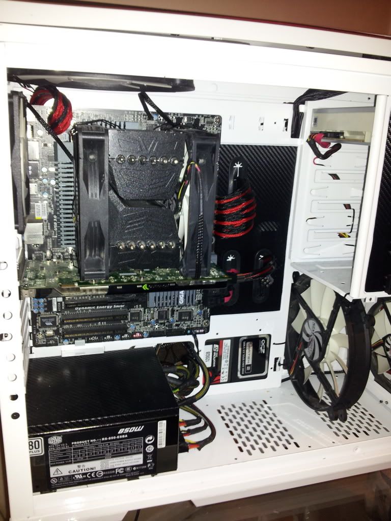

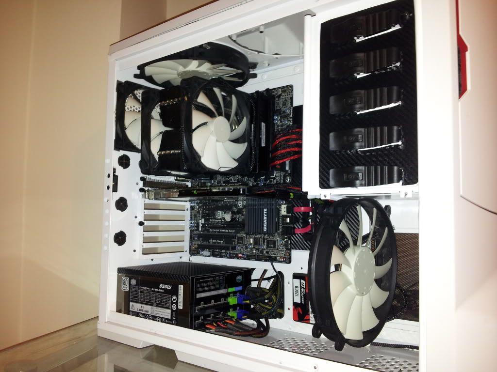

To OP, I have a phantom, i've removed both hard drive cages and mounted a fan on the bottom of the optical drive bay, will upload a photo on Wednesday after i've fitted my 670 when it comes.

Here you go mate, 670 isn't here but I thought i'd run through the other 6 pin so it can just go straight in when it gets here. the airflow boost you get by a 200mm fan being there is great. :) I'd definitely recommend losing it as a side fan and putting it where I have, you have to drill out the large HDD cage as they are rivetted in! The small one is screwed in. You will also need to remove the 2 side fans on the side panel which goes over the hard drives, they're pretty useless anyway.

Tbh the Phantom has good airflow, it's not like it's a bad case for it. Just with a few tweaks it can be made a lot better (Like the majority of cases)
Most cases will have HDD bays right in front of the intake, and if they are full of drives they block a lot of it. Get the drill out. :p
