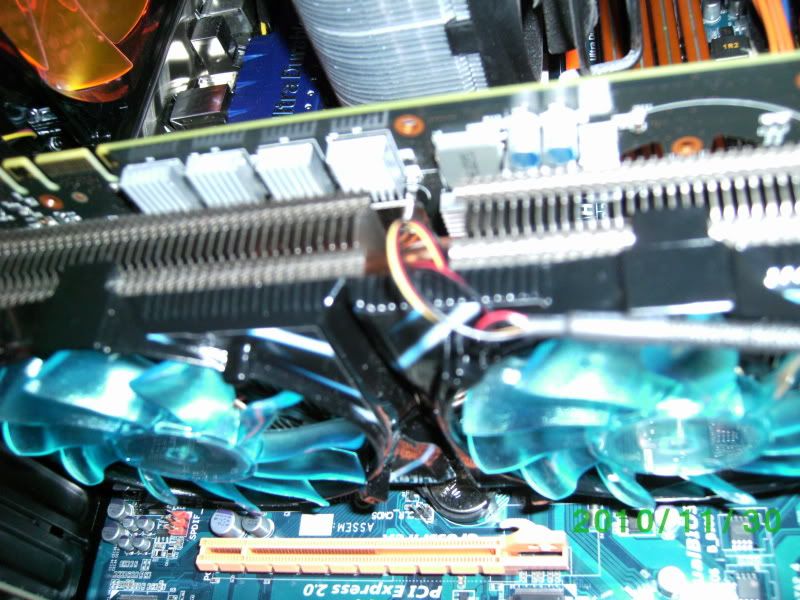

I have just fitted the Gelid Icy Vision Rev 2 to my Msi 470GTX and there is no chance of getting another card in the next Pci-e graphics slot, at least on my setup. thats with a Gigabyte MA790X-UD4. This picture shows how little space there is with the Gelid fitted. By the way, with the stock cooler the idle temps were 36c-40c. With the gelid 26c-30c. Playing Fallout NV with stock cooler 79c max. With the Gelid 39c max. Used Msi Afterburner for temp readings. Fitting the Gelid was fairly straight forward following the enclosed instructions. I gamed for about an hour to warm up the card nicely and the stock heatsink\fan came off no problem. Removed all the backplate screws using No 1 Philipps and applying steady pressure. Putting on all the ram\vrm syncs was a bit footery(big fat fingers) but manageable. Used Arctic Ceramique instead of the supplied paste on the Gpu and fitting the heatsink\fan unit was easy again following instructions. Pleased with the resulting temps and also worth noting I've also seen a drop of 3 or 4c on my cpu temps. The fans on this cooler run at 100% all the time and although they are fairly quiet compared to stock fans I'm thinking I will control them and turn them down a bit. Would certainly recommend the Gelid as an alternative to the Zalman if only because it seems to reduce other temps in the case.
The reviews that I read about both the Gelid and the Zalman coolers observed that both use 3 slots - I would think that Sli would be difficult on most if not all motherboards.
Am running a P5Q-E myself so no ? of Sli - but looking to see if it would fit I believe it might be possible but problems:-
2 (rather than the standard cooler 1) slots would probably be unuseable - I cannot see even a very low profile card fitting but....
The fans fitted to the top slot card would be very close to the top of the second gpu unit (not going to help cooling!)
Not sure but I believe that it might either interfere with some of the fixed motherboard components at the bottom of the board or overhang the bottom of the board and cause other issues.
Did think of crossfiring with this board but decided that it was only really feasible with single slot cards or ,at best, 1x2 slot and 1x single slot
