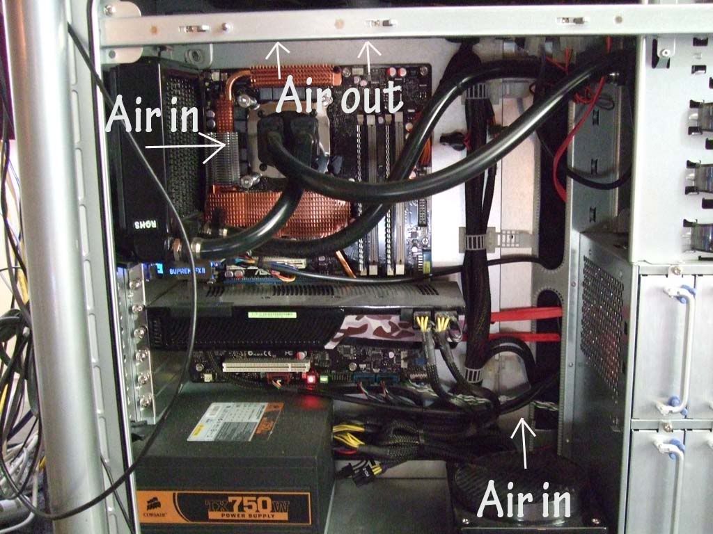

Ok its show and tell :)
There's 2 fans in the top taking air out and one at the bottom right bringing air in. I was thinking about putting a powerful fan at the bottom right.
Another thing I was concerned about is the radiator on the left bringing air in where there is normally a vent area

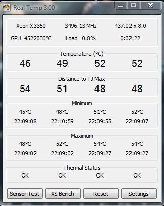

The CPU (or whichever part) would have to get seriously hot to shut down. Have you got any temperature monitoring programs so you can check just how bad this is or if some other part is overheating.
You didn't mention any temps in your OP so I guess you don't but programs such as Real Temp or CoreTemp would be fine.
The obvious flaw with that arrangement is that the 280gtx blows out a lot of hot air, as does the psu, both of which are promptly sucked back into the case through the radiator. That's a fairly silly way to set it up, turn the radiator fan around and use the top fans as intakes and you're done.
If you're not running clear coolant there's a good chance your cpu block is now full of dye and so not working very well. The ek supreme uses 12mm M4 torx bits which will be difficult to remove if you don't have an appropriate torx screwdriver.
From looking at that pic I would guess that the radiator would benefit from another fan this side of it for push-pull.
I would also agree with above and suggest you reverse the flow of air through the radiator so that it exhausts the heat out of the case, because as has been mentioned above, all it is currently doing is sucking in all of the heat exhausted from the 280GTX.
Having reversed that, keep an eye on temps, and if you feel it could be better, then consider reversing the fans on the roof so they intake rather than exhaust.

Its definitely the processors
They are 52 at idle on a cool day and 58 on a hot day.
Running prime95 temps jump up to 80s and 90s then pc shuts off.
I've already tried reseating the cpu, didn't help much.

I have this system and suffer similar temp issues. I added a push fan to the radiator, not sure why yours is pulling into the case as im pretty sure mine doesnt but i will have to check that to be sure.
One question that always niggles me is the orientation of the radiator itself, with input / output nossles at the bottom of the radiator. Surely it would fill better with fluid sat on its side, with input going in at the bottom and output at the top, as the air that could become trapped when filling should naturally head to the output nossle rather than get trapped. Even input and output at the top seems a better orientation than both at the bottom surely?
The bottom line though is that single unit reservoirs and single radiators dont seem to be a particularly efficient cooling system as the low quantity of fluid soon warms up to a point where it isnt really going to cool the processor very well...
I had a big long post with ideas of how to improve airflow but with a single rad setup and that case it makes it really hard. I was going to buy that case at one time but man the airflow in those are just not good by todays standard. They look cool but just are not that functional for overclocked systems because they are so restrictive.
One of the major problems is the hard drive bays and lack of airflow most cases give ya from the front. Even if it did have front vents through the door that wall they call a hard drive bay wouldn't do much trying to get through the few pinholes they put there. With a big vid card that bottom fan just does not look like it has the juice to get enough cool air in.
If it was me I would look into trying to mount the rad on the top if it will fit. Flip the back fan as exhaust and buy a really good replacement bottom fan that will push a lot of air. That case is pretty sealed up so a higher rpm fan shouldn't make it to noisy.
A Megahalems might be to long for that case. You will need to measure from the cpu to the door and google some specs. Honestly I am not sure it is worth the money to buy a ton of new fans for that system unless you wanna revamp and maybe look into a top mounted 240 rad.
If your feeling handy and there is room as I can not tell from the pic a dremel and a added 120 at the bottom might help some or even making the whole bigger and getting a beefy 140mm down there. the vid card will restrict it but it would be more positive airflow.
