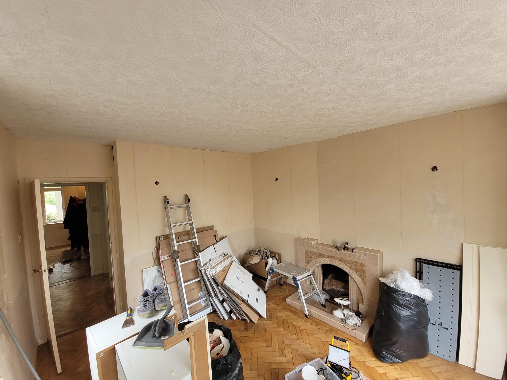

Hi all, I’m looking to place a tv above a new gas fireplace. I intend to build out a stud wall centred approx 1.8m wide and 400 deep). My speakers /av kit/ Xbox will be to each sides with possible shelving.
I recognise there needs to be 400 Clear above the fireplace from the documents but can’t get head around flue requirements. What I’m struggling to find out is if there’s a minimum to dimension “A” in the below? Can I just right angle the flue straight off the fireplace and then directly upwards? There is a chimney behind this in pics.
I will then use this dimensions to work out the centreline to the Tv and see if it will be ok viewing angle or too high. I intend to have a centre speaker and 65” Oled or led tv above
I looked briefly at electric fires and couldn’t see similar quality ones but interested to hear any recommendations. I know that may make it easier for me but they tend to look a bit naff from what I’ve seen.

Pics below including current room (very messy as removing wallpaper)
proposed gas fire pic of pdf requirements
naff sketch
It is the “drawing” room below
Pics of room
