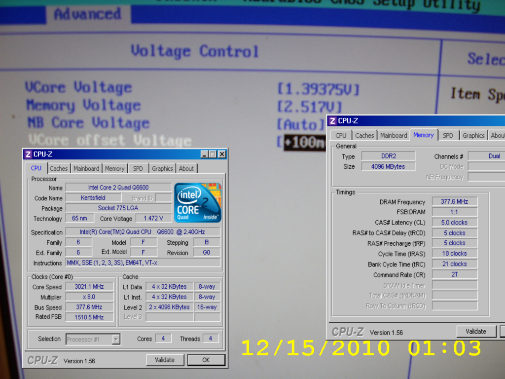

Getting 4GB ram to work on overclocked Q6600
Hi again.
I wonder if anyone can help me with this. This is about memory but is to do with my OC, so am posting here.
When I first got hold of my computer, the frist thing I did was over clock it. The P5NE-SLI is not a very good motherboard for this sort of thing.
I only had 2GB ram then and was not a problem. I now have 4GB ram but have been running on stock speed with some adjustment in memory volts. That was with some help from the manufacture.
Problems is, I can't boot with 4GB ram and use my overclock settings at the same time. I have put up the volts but still no boot. I am worried I may burn out my motherboard.
So could I have some help with what volts and what I need to adjust?
And overclock volts.
This is when I had my OC going and with only 2GB ram
This is my current settings.
5-5-5-18-22 2T.
memory voltage 2.353.
Memory is corsair CM2X1024 6400.
4x1GB Two pair sets.
If You need more information, I will do my best to get hold of it.
Thanks :)

Have you tried upping the NB voltage a couple of notches, running 4 x 1gb sticks of ram puts the NB under a bit more strain, therefore you need to up the voltage to compensate this.
Thank you for the reply.
Not much luck.
I tried upping the NB to 1.748 but no luck. Plus I found out that, the NB won't go no higher than 1.748 then it's back to auto.
So I tried with the NB on auto but it won't load windows.
Memory volts was left at 2.353.
Think I now have 4GB working with my OC. I can't say if it's stable or am I sure I need to run prime95 again but it's working.
Hope I won't fry my motherboard?
Only put up memory volts to 2.517 and NB on auto.
See picture here for settings and cpuz. :)
I don't recommend the P5NE-SLI for overclocking at all. :)
