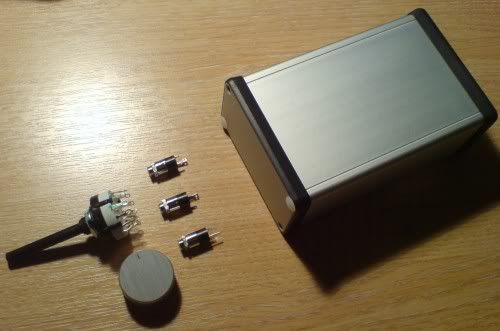

Just thought i'd update this if anyone's interested. In the end i went with a Lorlin rotary switch like -Ad- suggested. Took a while to get everything delivered as i changed my mind about using ordinary equipment wire and bought some Starquad instead.
The first enclosure i bought also turned out to be way too small, the switch would not fit at all. Serves me right for not checking beforehand. The second enclosure i got is much more appropriate i feel. It fits much better on my desk.

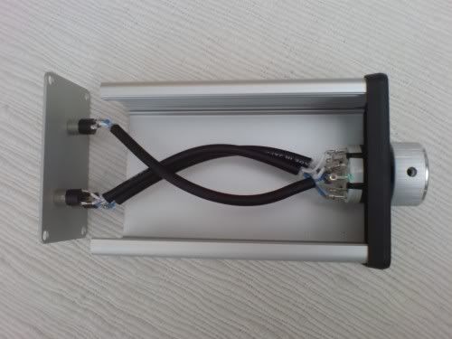

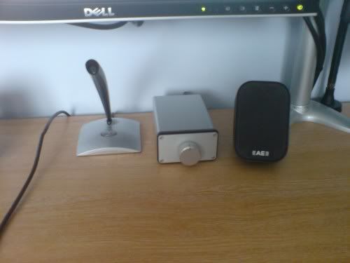

Anyway, here are some pictures:
All the parts
Internals
On my desk

Good job, looks nice and clean.
I have exactly the same jacks, knob and rotary switch in various projects. :p
As it happens, the first enclosure i bought that was too small was the same size as the one you used for your cmoy. That might give you an idea of how optimistic i was being :D
I used different jacks when i built my cmoy (these) but much prefer the ones i used for the switchbox. Bigger solder tags and higher quality feel.
Nice work, what enclosure is that?
Thanks. It's a Hammond 1455K1201. You can get it at Farnell, Rapid etc. I used a Hammond enclosure before and was impressed by the quality, so i got another!
