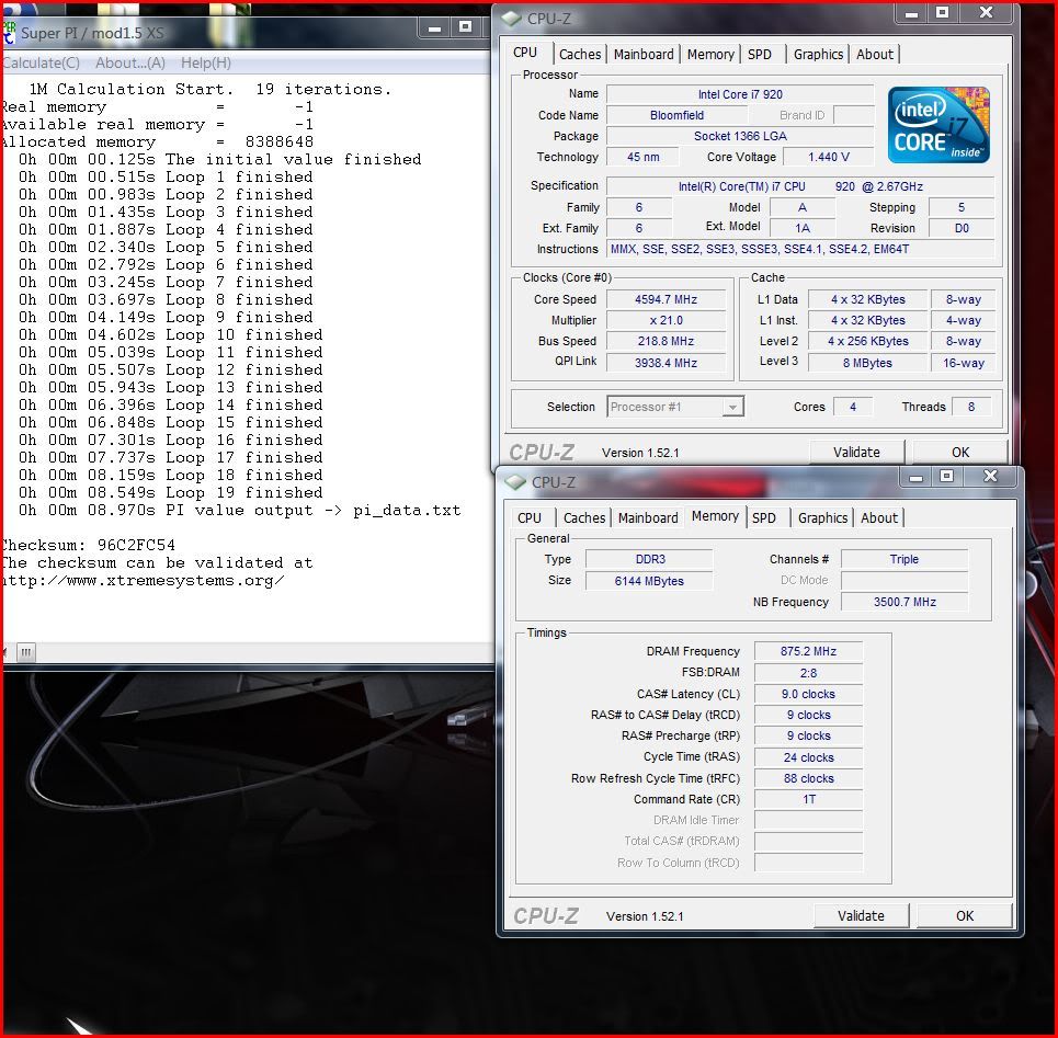

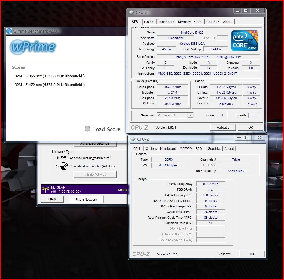

I managed to get 4.6 for a few benchies and didn't have to go over 1.45

Idle temps were about 40C and max temp about 60ish, but i didn't bother to do any stress testing at 4.6 as it wouldn't have made it...i was just trying for some high benchies.
At 4.4 where the max temp was 70C while stressing on the highest core (i was running at 4.4 as my 24/7 clock for a bit) remember i had a quad and a triple (thin) RAD in series and was also cooling the chipset and GPU so there was a lot of cooling.
Settings wise 220 x 21, Vcore 1.45, qpi 1.8, RAM at stock and everything else a few notches above minimum, I was using Trident 1800 rated RAM.
I had a good CPU, i tried another one in the same set up and was unable to get anywhere near this, i thing it maxed out at 4.2Ghz and needed 1.35 to do it.
As for saying "ive got a 950 not a 920"??? its exactly the same CPU with a different multiplier nothings stopping you using the same settings...in fact in theory as you have a higher binned chip it should be easier!! saying that ethers a reason that the 920 at the time i bought it was the chip of choice as it was just as capable as the "higher" binned chips.
