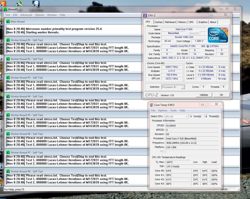

Currently I'm running 3.6ghz with 1.18v (200x19) temps creep up to around 75 using core temp after a about 30mins on Prime 95.
Is this a good overclock to be keeping the system at constantly? Should I continue to lower the CPU voltage until the system starts acting up?
Heres a link to the Screenshot of my O/C, please tell me what else I can do.
Thanks,
Jonny
http://i49.photobucket.com/albums/f289/Rusteh101/Overclock.jpg
I was wondering, what can be used safely as an everyday overclock with low voltage?
It depends entirely on your particular chip and what voltages it needs to remain stable at different settings. There is not a set figure which all i7 920s adhere to unfortunately.
I would say that your overclock looks OK - I normally say that anything less than 80c @ load is acceptable (obviously the cooler the better though), over 80c is dodgy ground imo.
You may have already done so but personally I would test any overclock with Prime95 for longer than 30 mins, more like 4hrs+.
What board, ram and more importantly what cooler are you using Rusty noob, i7's do tend to run pretty toasty when overclocked, but even with half decent air cooling they can clock to 4ghz with reasonable temps. The max voltage reccomended for the cpu is 1.4 vcore.

For my own i7, 1.18 took me to 3.6ghz as well, its only when i went to 3.8ghz i had to up the vcore and qpi/vtt voltage, 1.2750 vcore and 1.300 qpi/vtt, (same voltages worked for 4ghz as well) id say that the arctic freezer wouldnt be an ideal cooler mate if you want to push higher, im using the thermalright ultra extreme 120 with 2 fans in push pull, highest temps at 4ghz are 73-69-68-67, it is a pretty expensive cooler particularly when you factor in the price of 1 or 2 fans to use on it, but ive had it on 3 intel quads now and its more than paid for itself.
