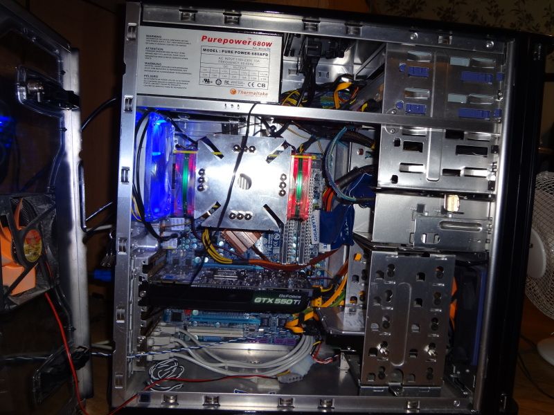

Anyhow with the problems aside will this cooler perform better than my current scythe cooler assuming that its 100% working as it should with no faults? Or will the temps be much the same as the scythe cooler?
This is the scythe cooler that I have:
http://www.scythe-usa.com/product/cpu/026/scnj1100p.html

Your cooler is quite old so that makes it hard to find reviews comparing it to a recent release like a Corsair H80. This obviously makes it hard to provide a definitive answer however from the reviews of the H80 I've read the answer is yes, although it may not be a huge difference. About what doyll suggested, 5c or a bit more due to your current cooler/case/fan layout.
I've had a look at your other thread and your cooler setup, did changing thermal compound make any difference? A remount using the pea method, putting a small blob in the middle and using the pressure of the cooler to evenly spread it out. Also moving the fan to push air towards the extractor would be a good idea if the ram doesn't interfer with it. Even if you cannot affix it properly you could at least see if it makes a difference.
Ultimately if the H80 does not improve your temperatures enough, you can always return it using the DSRs, you just pay the postage back to the retailer.
Im on my 4th corsair h80 in a short period, luckily the place i bought it happily exchange when i take them in and i live pretty close. Although the pumps failed 3 times they are still a great cooler, i was looking at changing the h80 and may well do in the future. As for performance on 5ghz on prime it doesnt go above 75 and 12 hours. So its pretty decent. As said though pump problems are very common mate.
Thanks for the replies every one. Thanks for reading my other thread Speed. I have not ordered new thermal paste yet to try that but I have re applied the paste. I put a rice grain blobbed size in the middle of the CPU and re fitted the cooler. I was doing a bit of research as to what paste is the best to get before ordering. The stuff I used was cool masters branded but after reading the forums I think I am going to order IC diamond to replace it with. I have also broken my scythe fan on the CPU cooler and have fitted two smaller fans in push pull config and pointed them towards the case exhaust like this:
This however has not made a difference to the temps, they are staying about the same. I am really running out of idea’s on how to get my temps down now. I have had the case panel off and pointed a desk fan in the case on full and the temps dropped 1-2c . I have put the side panel back on and pointed the desk fan at the intake fan on the front of the PC and the temps still stay the same. I have also been monitoring the temperatures outside my case and inside my case. The outside temp just now is 27.3c and the in case temp is 28c. If the PC is stress tested the in case temp can hit 35C. So I don’t think air flow in the case is a problem?

Your case temp rising to 35c under load is with ambient at 27c under load? Or is that when ambient is 22-23c?
Mine case is 2c above ambient idle and 3c above ambient 100% load. If GPU is under load too case temp is 3-4c above ambient... My GPU is HD5770 Silent Cell... passive cooled so all heat is in case.
Cooler exhaust is 7-8c above ambient idle and 12-14c above ambient 100% load.
My cooler exhaust is ducted out of case so no cooler exhaust .heat stays in case.
I would try some proper fans on your cooler. You can get a decent fan for about 6 quid. Ask Speed. He is pretty sharp. My guess is it will cool much better.
Your case is a big part of your problems. I had a Xaser III before my Define R2. Had done major modding to increase airflow on it.
Thanks for the replies. Yeah those are case temps not CPU temps I would be over the moon if they were CPU load temps. I did read that the IC diamond paste was awkward to use the other paste I was considering was AS5 (I think that’s what it’s called?) But am I right in thinking that it’s conductive? If the Arctic MX-3 paste is decent then I shall order that instead.
The in case load temp is 35c when the outside case temp is 27c. The load test is just a CPU stress test with Intel burn and not a video card test. Doyll the Xaser III case has more fan slots on it than my case does. Which is worrying if you had air flow issues with it. I did think about changing the case fans for better fans but I wasn’t sure if that would help. I suppose at £6 a fan it wouldn’t hurt to try it and see. I would be willing to spend more on case fans though if it meant getting better performing ones.

There are a few mods that I think would solve your problems.
1. Put 1 or better 2 fans in the bottom and raise case at least 55mm. I make a caster base to solve this problem. SilverStone sell some nice filters that attach magnetically ;)
2. Remove all unused PCI slot covers to allow hot air out.
3. Remove the metal grate on back exhaust duct.
A couple of good fans on you cooler and possibly duct exhaust out the vent hole so heat is forced out. Need to be careful with duct to keep airflow to PCU intake.

Hmmmm I would prefer not to butcher the case if it can be helped. I am not too sure that adding two fans in the bottom of the case will help. As taking the case panel off and pointing a desk fan in the case didn't do much for the temps. I already have the spare PCI slot covers removed. Perhaps changing my current case fans for some better performing ones would help?
Cases with decent airflow usually have 2x 120/140mm fan in front and usually 1x120/140mm in bottom.

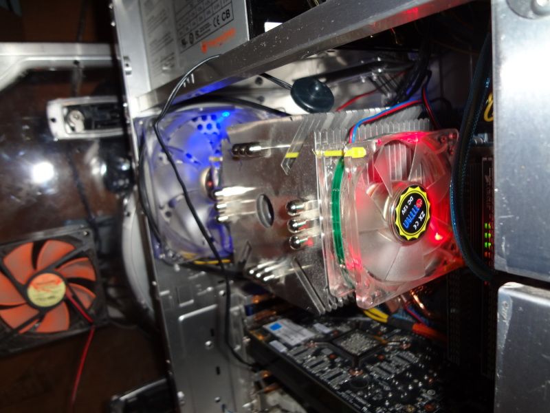

Your cooler really needs some bigger fans. Those are dinky fans you have on it now. Isn't it supposed to have 120mm fan?
They look like 80mm fans on the cooler, I suspect that is more to do with space than anything else. He had trouble fitting 120mm fans due to the Ram and Motherboard heatsink if I recall correctly. Even if you had to have the 120mm fans sticking out above the cooler slightly they would offer better cooling than the current ones, so as long as the side panel goes on I'd give that a try.
The case has 120mm intake and extractor if the specs are correct, so that should be fine airflow wise. I think the hard drive bay is also removable so putting the hard drive up the top or down the bottom with the cage removed should improve airflow. Also check that the filters on the intake at the front are clean.
How are the case fans connected? 4-Pin molex or 3-Pin to the board?
Ultimately though this is all pointing towards buying a new cooler or a new case.
I did have a scythe 120mm fan on the CPU cooler to start with but while checking the PC and checking to see if the heat pipes on the cooler were getting warm under full load I managed to break a blade off the fan :(

It is 80mm fans on the CPU cooler. The case spec's are correct there is a 120mm front intake fan and a rear 120mm exhaust fan and a 80mm on the side window. I shall try removing the HDD rack and see if that makes a difference. All the filters are cleaned and free from dust. I cleaned out all the dust in the case and on the fans, I even removed the filters completely to see if this helped but there was still no change in temps. The fans are connected to the motherboard 3pin connector apart from the side window fan and one of the 80mm fans on the CPU cooler which are connected to a Molex. I shall try fitting a 120mm fan to the CPU cooler, I don’t have one spare so what one would be the best to order. Noise isn't really a concern as long as it’s not like a plane taking off.
Many thanks to both of you for your replies, I hope we get to the bottom of these temps soon.
A 80mm fan has half the area and move about half as much air as a 120mm fan ;) My guess is a 120mm fan will perform better then the 2x 80mm fans you now have... and 2x 120 fans will be even better.
Ok what fans would you recommend for use on the CPU cooler?
