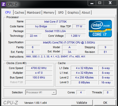

Well heres the latest, I have my new ivy bridge setup now fully up and running at 4.7MHz overclock speed, compare that with a sandybridge clocked at maybe 4.9MHz and look at some benchmarks that youz will no doubt have seen in youtube videos etc and reviews and you will see the ivy bridge technology bypasses the sandy even with the ivy on a slightly lower clock than the sandy

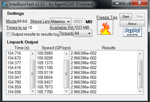

I used Intel burntest v2.53 to benchmark my overclock settings @ 4.7Mhz and the cpu voltage I set at 1.290v and got it stable at that, Burntest was set to "maximum stress, 10 runs & all threads" took me a while to find the correct voltage but got there in the end, , the Highest tempreature I got under full load was 47c (never seems to go below about 33-35 on idle unless just switched on which is obvious), so I dont really know if thats good or bad (is it ?) as I have nothing to compare it to unless someone comments please ?
But 47c on full stress seemed good to me and thats why I ran the test a few times just to make sure, would still love to hear opinions though please :);)

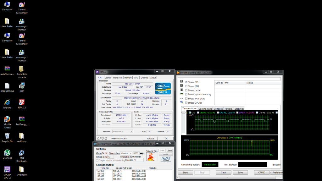

Ok, for anyone doubting what I am saying I have just ran the stress test again a few times and this time I made sure to capture a screenshot of the tempreature and everything else, please tell me if you cant see the picture very well as I also took several photos using my digital camera too which may be clearer.
At the point when the screenshot was took the room tempreature was approx 24c, give or take a few degrees as home thermometers are always at least 1 or 2 degrees out unless you have a really expensive one I guess.
My cpu voltage is fixed in the bios @ 1.290v although as you can see in the cpu-z picture it says its slightly less but I can assure you its fixed @ 1.290v in the bios and it doesnt go up n down with more and less stress, as I say, its fixed.
The cpu speed is 4.7, the ram speed is 1600 and ram volts are 1.50, I also have speedstep and turbo enabled.

I would suggest trying a different program such as coretemp to see what it reads, I find it hard to believe your cpu is really at 47c, mine peaks mid 60's at 4.6 with 1.24v yet a lot of other people report much higher temps with the same speeds. As for idle temps it depends what you have the fans set to as they normally slow down when it gets cooler, mine idles in the mid-high 20's.

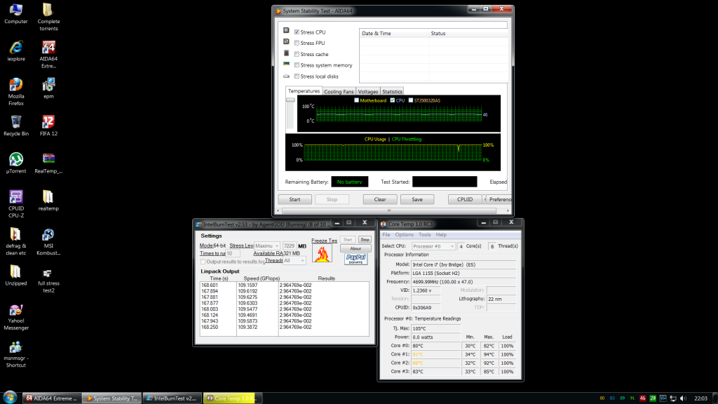

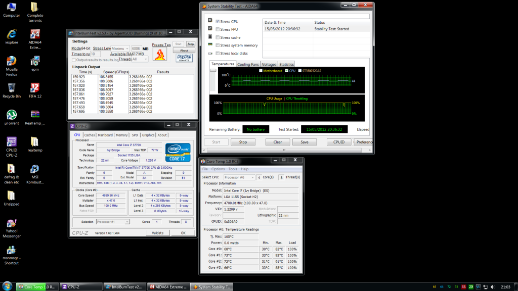

It just monitors the temps of your CPU, run a stress testing program and see what it tells you. I just figure it's better to get a second opinion and if they both report the same thing then it means it's more likely to be right. If you go by others with a setup the same as yours they get much higher temps at those speeds so you have to suspect something is wrong somewhere, either that or you have an amazing chip
ok, another test done and this is the results near the end of the test and as you can see I used coretemp and AIDA64 too, by the looks of it they are giving totally different results, I cant understand this as aida64 is in my opinion always the best program to use by far, even the guys from good overclocking videos for my exact board and cpu on youtube use aida64 too (one guy is the asus rep, i think its a newegg video or summit), so now its like what the heck do we believe here, when we start to bring in other programs then whats to believe :confused:, I would imagine that a lot of software bench apps etc are still not fully working properly with ivy bridge as the thing has only been out since the very end of april 2012 as we know, hmmmm, interesting isnt it ?

Your results with coretemp are in line with what everybody else is reporting (see the IB overclocking thread), I personally wouldn't go pushing it any further with those temps. Your version if AIDA is also very out of date which is what most likely explains it, the trial version I dl'd from their site is 2.30.1900

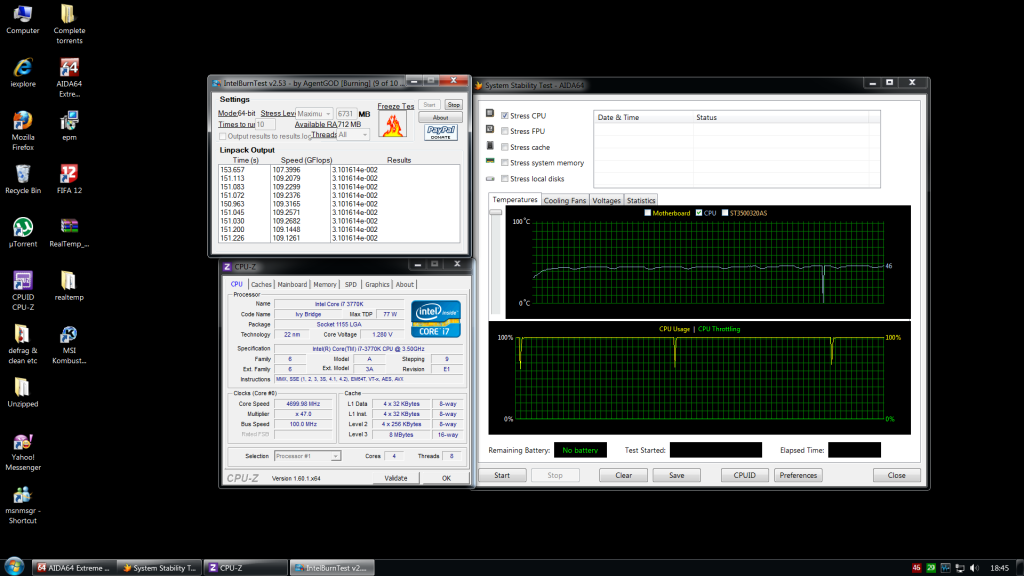

Ok, I now have the full version of the latest AIDA64 EXTREME EDITION fully licenced too, lol :D version 2.30 which is recommended as I say with asus for my board and the ivy bridge.
And it does just go to show earlier what I said was quite correct, some other tempreature and stability programs are not up to the job yet with the new ivy bridge platform, even my older AIDA64 version was giving me very inaccurate low readings as you can see with my few posts above and then when incenorator suggested I get the latest version then yes that certainly made a big difference and that is quite obviously the version the asus do recommend and not the older version or other programs too.
You can see now my maximum temps are more realistic, hitting between 52c to 72c maximum under full stress and as I gather from what others have said, to be in the 70's @ a 4.7 overclock with the ivy bridge is perfectly fine, is that correct, just wanting too treble check that so to speak, lol, just in case ??
My idle tempreature even with the latest version of AIDA64 (2.30) is still settling at about 33c-35c, so thats the same, I am trying to think of a way to get that idle tempreature down, does anyone have any ideas ???
Anyway, heres the latest picture with the latest version of aida64 that asus recommend ;)>>>>
