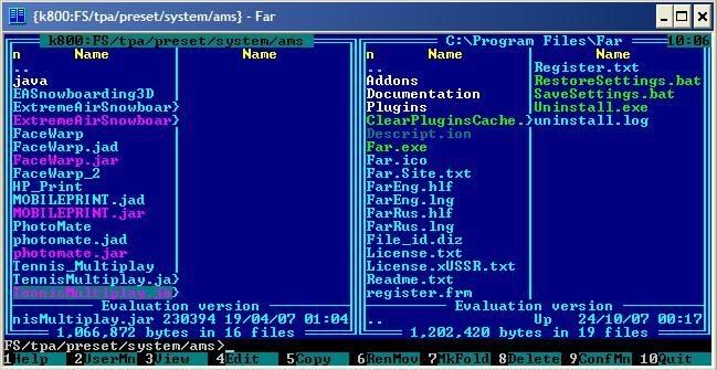

One option is to use something like Far Manager with the CID51/52 SEFP to break into the phone's filesystem and physically delete the files without the operating system getting in the way. I'm 99% sure that would work, but it's complicated and a tad risky.

Just downloaded that program, and I dowt Ide have a clue on how to use that, even though I am computer literate.. (dont know how it finds the phone, currently only in the programfiles\far folder :s)

Hmm yeh it's not a simple program by any means! Been a while since I've used it and I can't remember offhand. If you feel like persuing that route, it might be an idea to have a look around Se-nse & Esato, sites like those have tutorials etc on accessing the internal filesystem.

hmm I think I know how to do it now, just need to find the file for the k810i
Do you still have it mate? I had the one for the w800 and k750 but they obv wont work
Hmm Seemed to have figured it out. yet the program doesnt pick up the application/games folder.. So its pretty pointless :mad: And the other folder is empty as it is

I don't know if I've still got that file, I'll have a look. Sounds like you must have the CID51/52 SEFP plugin if you managed to get into the filesystem.
Once in, go to "FS", not "FLASH". Then, go to the directories:
- /tpa/preset/system/ams.
- /tpa/preset/default/java
and delete anything that looks dodgy. It should show the file size (IIRC), so that'll help.

Well I just deleted some jiberish files from the ams folder containing something of the lines of jkiuf98798745kjkjh.. Files are still there like
Java folder seems to be empty, and I doubt theres any link between them, just from the look of the way the names spelt (aceWarpĂ▫▫▫▫ with a domain of F4:0) aswell as a blank name, so it seems fishy. And to be honest I dont even think the phone holds that much memory for both files (100mb)
