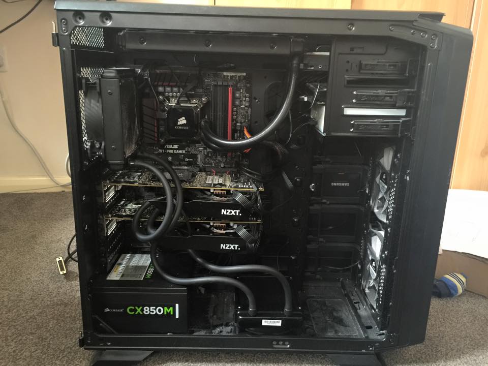

KFA 980 SOC SLI top card hitting over 90deg c.
Installed 2 120mm fans into my case, 1 on top 1 at the bottom. Temps now sit at around 85deg when overclocked for top card. Going to put another in front of case where drive bays are.
Plus my latest card (KFA 980 SOC) is still making a slight clicky sound at high fan speed. Ive inspected it and cant find the source.

It might be worth removing the HDD cage and placing your drives in the ODD bay to remove the restrictions on the front intake fan.Also put a fan on the bottom next to the PSU wouldn't hurt either.

This is the routine I run with SLI/CFX.
a) Swap cards (the bottom card might be better in the top slot)
b) switch sidefan direction and/or create better positive pressure with other fans.
c) put a fan on the side of the HDD bay blowing over cards
d) replace GPU thermal paste with something like mx-4
(last resort measures below)
e) undervolt and underclock
f) place a big normal fan blowing full speed at the cards :) (used this one when mining with a custom open case)
I did A) and it dropped my top card temps by 10c :eek:
