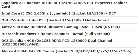

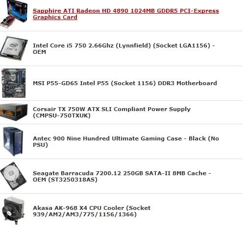

RIght recently i decided to get myself a new machine and not knowing that much i based what i bought on this rather helpful thread http://forums.overclockers.co.uk/showthread.php?t=18060182
from that i went ahead i bought
most items from the £700 intel build with the exception of the case and the PSU

anyway back on subject i went to ATI's site and looked at the trusted PSUs and got myself a
Corsair TX 750W ATX SLI Compliant Power Supply (CMPSU-750TXUK)

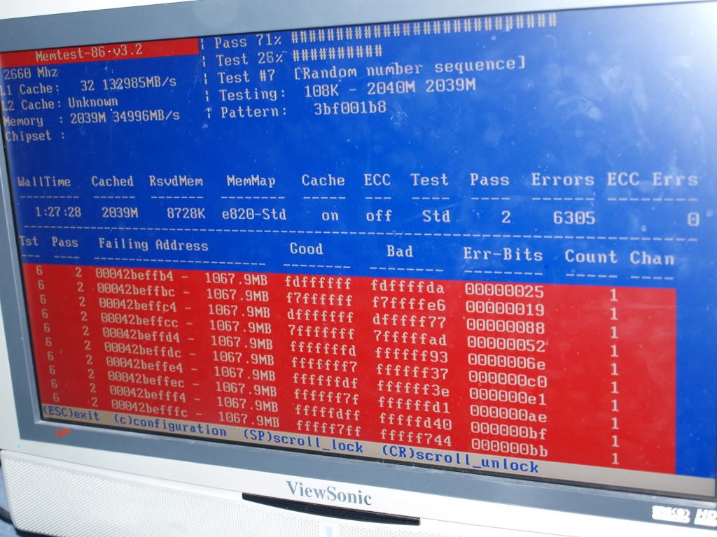

About the memtest i finaly managed to get it onto a disc and removed the 2nd stick of RAM and ran the test so far its done 1 pass and already im staring at 2500 errors and ill leave it running over night and test the other stick tomorrow
If both sticks turn out to be "faulty" what is the likelyhood its a compatibility issue or just a set or that they are actualy faulty and is it worth me running the tests again after i install the new PSU?
There's your likely issue then.
If both have errors I'd suggest contacting the store for advice on replacement or refund.

counting that many errors in so few passes is it worth me continuing the test or should i just move onto the 2nd stick?

After running 4 passes n the 1st stick of RAM i was looking at over 10k errors i decided that was probably enough for me to assume that the ram was faulty and i started running the test on the 2nd stick and as expected it poped up with over 7000 errors in just 10 mins on the walltime

Why are you surprised by this?! The RAM is fubar no?! Get it replaced then try again:)
