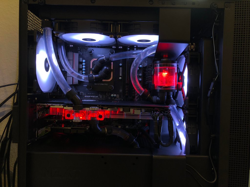

    [​IMG]
    Found a pic on reddit where 2 radiators seem to fit. Might struggle a bit with a decent pump/res solution though.
    Enthoo Evolv Matx TG fit a 360 and 240 when I had it although it's one of the bigger matx cases out there. Air flow is restricted though, I noticed around 10 degrees difference with the panels on and off.
    Using the H200i myself. 240 and 120mm was enough to keep my 8700k and Titan Xp quiet.
