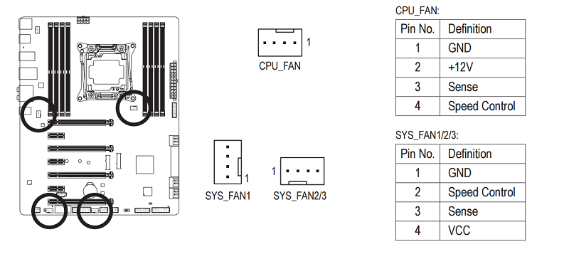

i have the same issue on my asus sabertooth 990fx r2 mobo so i would also like to know how to set it to voltage control, as of right now im using the cables that come with my fans to reduce them to 7v
Could it be the pin out is different from the CPU?
Stopped using th akasa cable and just a 2 way splitter and it controls the speed perfectly.
That's because those Sys fan headers only allow voltage control.
The Akasa PWM splitter does not support voltage control as the power comes from a Molex, not the header itself.
Onto the next issue. Your fans are rated at 0.7A each, so that's a potential current draw of 1.4A. Your fan headers are 'probably' rated at 1.0A. Do you see a potential issue?
You should not really use a splitter for such power hungry fans. Unless you can verify the actual current draw at max speed I'd be very cautious. Motherboard header fan control circuits are not generally something that you can replace if you blow the crap out of them.
