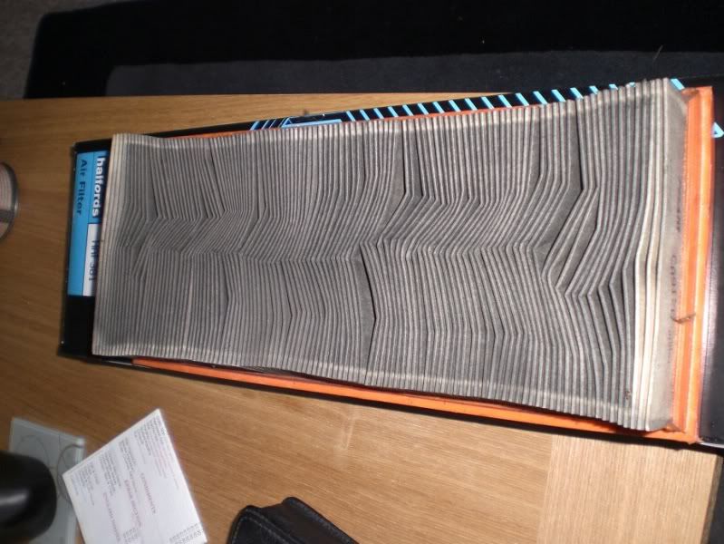

I've had a problem with the car (2.0 130 tdci with 50k miles) for what feels like forever where it will suddently run out of power at 2500rpm. No warning lights or any error codes..
I'm getting fed up replacing bits and paying for diagnostics so I'm hoping someone may be able to suggest something to help.
I dont believe it's a fuelling issue because of the lack of error codes or other symptoms. No smoke, no stuttering etc.
The EGR and inlet manifold have been cleaned (EGR is now blanked), the MAF has been replaced, the turbo vanes have been freed up. The latter smoothed things out at the low end but nothing on the high end. The air filter looks a bit dirty and the fins are a bit "bent" but surely an air filter couldnt cause such a big performance degradation?
It's been checked for boost leaks by different people on several different occasions with still no joy. Its driving me absolutely insane - does anyone have any more ideas I can try?
I'm now an extremely happy man because I've just fixed it for the princely sum of £4.99
New air filter and its a completely different beast, problem 100% gone :D

The flash makes it look lighter, its nearly black. It looks like its got to the extent where it was starting to suck the filter in at high boost, its completely distorted on the bottom (pictured) and curved towards the intake on top :)
The drive home confirmed it is indeed 101% sorted - third or 4th was always the real test, it would NOT go past 2500 rpm and now pulls hard all the way to 4600rpm. Not that I drive it that way normally, but its confirmed it's fixed!
