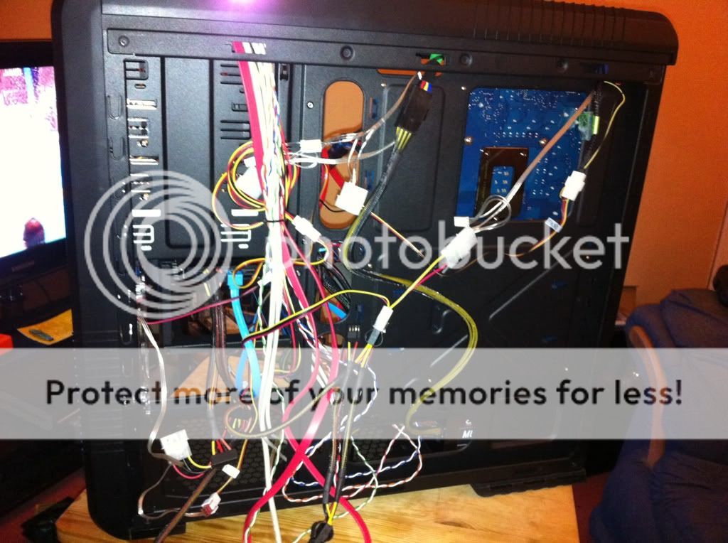

Though I'm not sure how I'll ever get this tidy :eek:

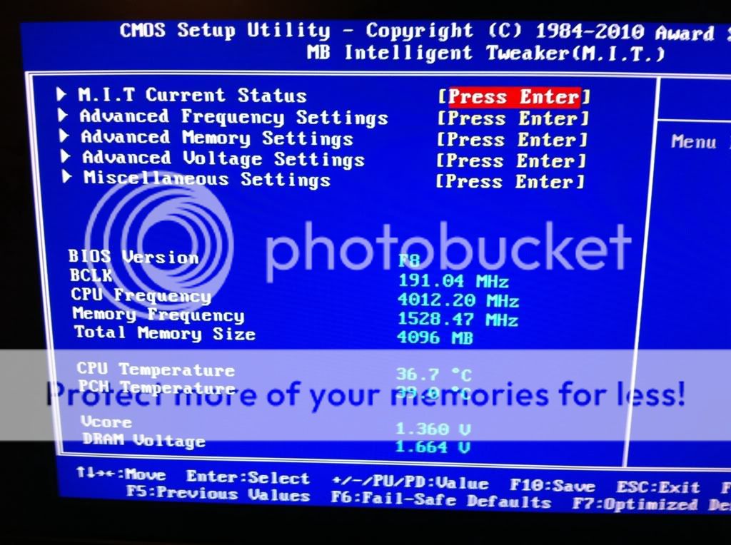

So far so good, though it threw me by displaying the bootup on the 'wrong' monitor. I'm quite enjoying looking round the bios. I do miss the days of DOS.
CPU temp in bios seems to be hovering between 35 and 37 at 4ghz.
2 options I can find that were in IDE but I changed them both to AHCI. Hopefully that's all I need to do to get my ssd working optimally (as far as the bios is concerned I mean)
Yep that's what I plan on doing but the braided cables are a little inflexible atm. I shall massage them or get extensions. Same with the pci-e cables. Braided might look better but they don't seem to like to play ball.

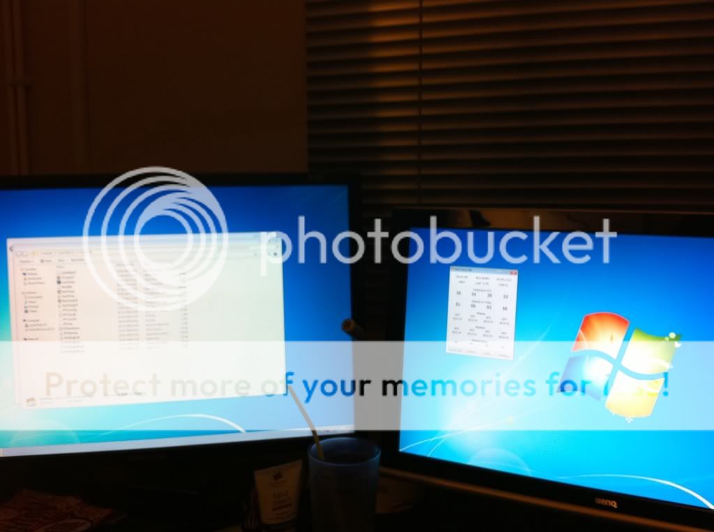

I just noticed that when running prime my overclock, according to realtemp, dropped back down to the i5 760's standard 2.8ghz? As soon as I stopped prime realtemp said the cpu speed went back up to 4ghz.
That seems a bit strange. Any idea's?
