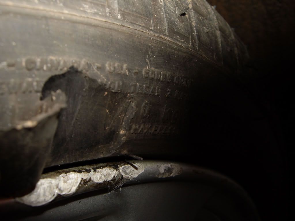

After a nasty run in with a flood damage pot hole ive got 2 nice chunks taken out of both my rear sidewalls so im after a pair of new tyres, 205/45/17 W. They need to handle pretty well, be safe in the wet and, since I do a fair ammount of driving for work not be made out of cheese. Budget around £70 a corner. The car currently has Pirelli P Zero asymetrico all round which are a both crap and expensive. Im thinking of something like the Eagle F1 GSD3 although I know the wear rate isnt great, anyone got any other recomendations? Also as a fwd woudl I be better putting the better tyres on the driven wheels and moving the pirellis to the back?
