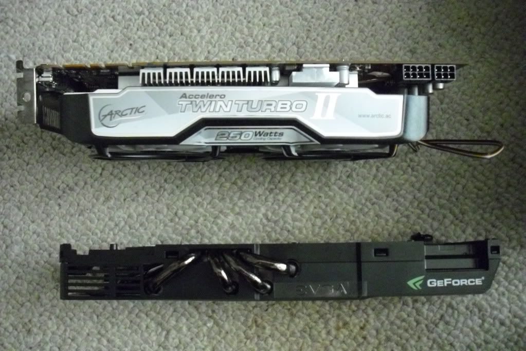

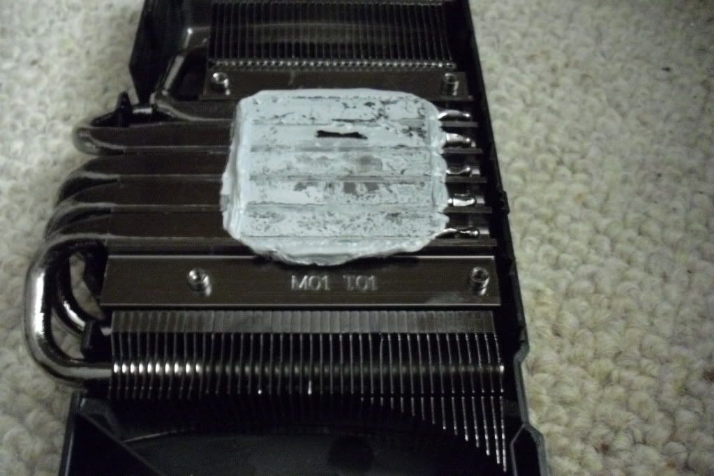

Here are some pictures camera is rubbish really hard to focus!! :mad:
Hope it works! I aint posted pics for a long time on the web! :p
Picture 1
Happy hour on the thermal paste at EVGA !!! :eek: Naught, naughty! :rolleyes:
Pic 2
Side by side the stock cooler looks like a brick and works like one too! :D

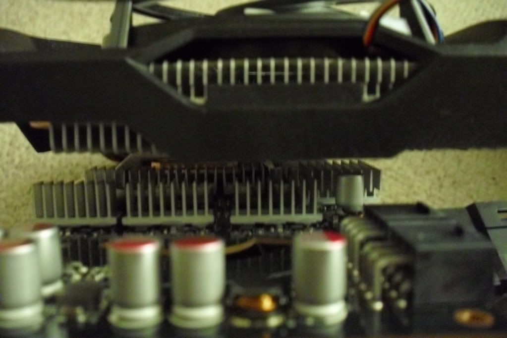

Pic 3
Top down view, yes it does take three slots up but worth it!

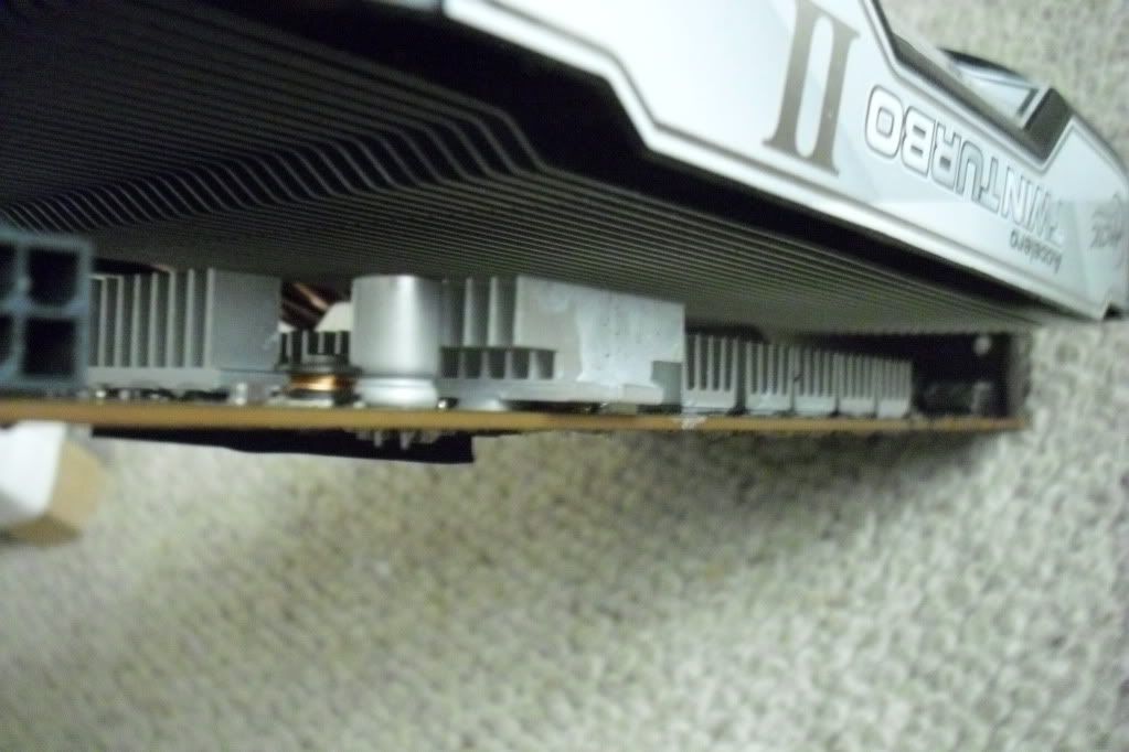

pic 4
Heat sinks oh so many heat sinks!! :eek: Spot the botch job because they only gave me 11 memory sinks, the 480 has 12! :rolleyes:

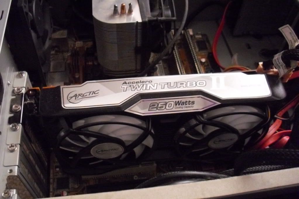

pic 5
In the Pc with a few bits removed to see better!

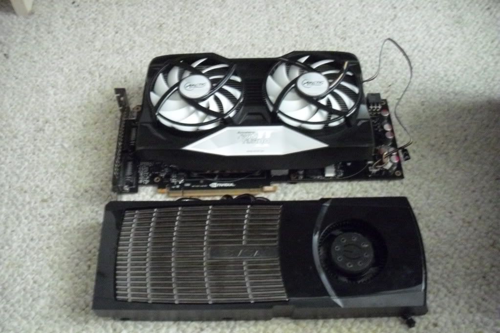

Pic 6
Altogether ready to go, the long black cable is the second MB power lead and its too dam short in a p190, was with my other psu just about stretches over the new cooler! ;)
It was not easy to fit had to improvise here and there but done it the end.

Aside from a ram sink short did it come with enough sinks to do the VRMs? it looks as though it might.
Yes VRMS and few others, I had to use two halfs for the last mem chip so was short for 4 small chips and as you can see from the pic i used 2 L shape types that just about fit! ;)
