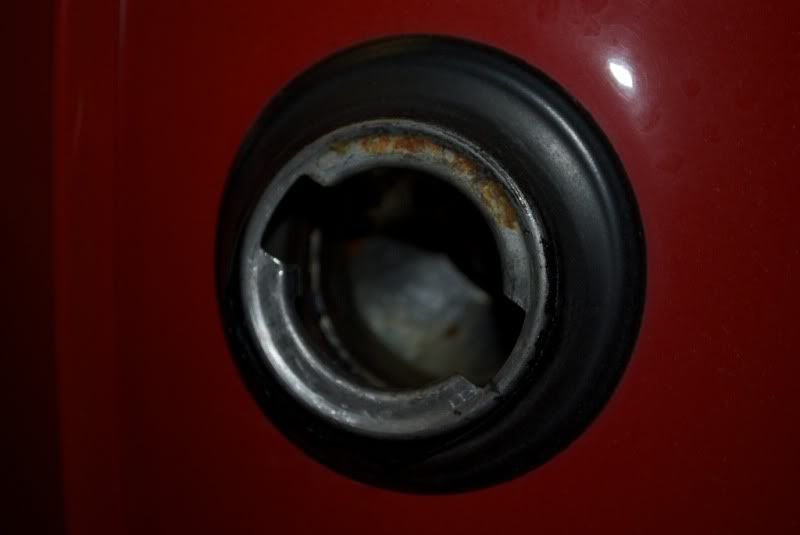

This is odd but understandable, with fuel cap off you can see the rust quite clearly. I think some Mini's have the Cooper S (?) fuel cap which might be better but its something to look out for.

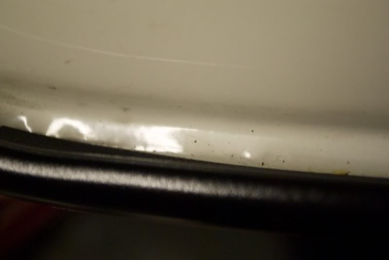

The roof, now this seems to use the same logic as a gutter on your house. Water collects and eventually (when driving) will go down to corners of the roof where there are gaps for water to escape. It's almost as if they over looked something so simple as water collects here when you leave it parked and it rains etc.

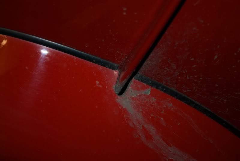

This part is what I meant when I said bulk head (which was replaced a year ago when I crashed). Make sure that this isn't showing bad signs of rust as it is a big job as far as I am aware to replace.

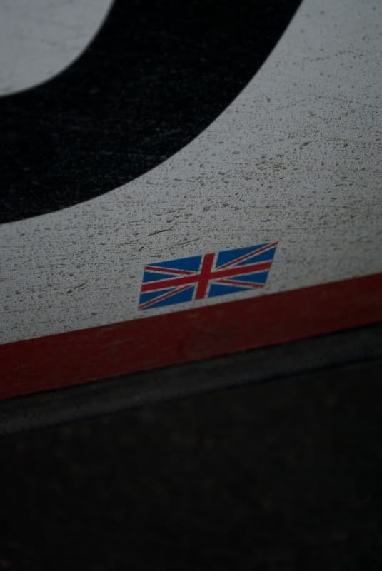

Don't know if you can see in this pic but basically bubbles of rust on both the drivers/passengers doors are likely from what I have heard. You can see a bit of red tape I have there currently covering it but I need to do some more work to sort it out when I have time.

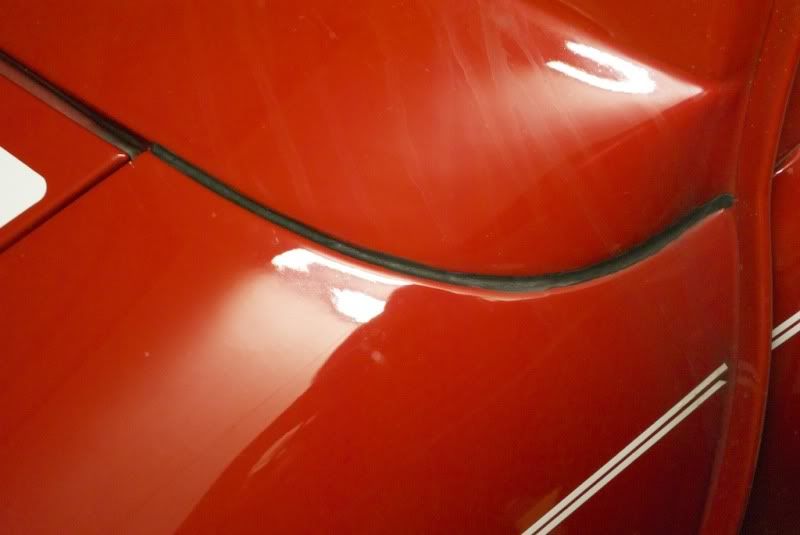

The car is very dirty at the moment but perhaps this is good for these photos because it shows were dirt/grime/water collects in places such as here, on the wheel arch.
Now this part which as you can see has been filled in/sealed is something my dad did years ago as he says its prone for rusting. Not sure what other owners think but there you go.

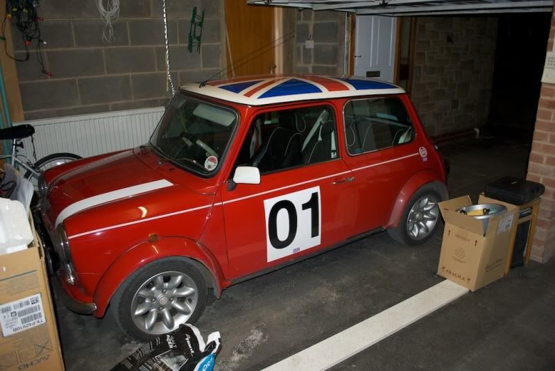

Tucked away in the garage...as it should be as its warm and cosy! ;)
