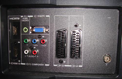

I am not sure if this will apply to your TV but my Samsung 5 Series won't accept 3.5 jack audio if you go DVI -> HDMI. My TV expects both audio and video to come via the HMDI cable.
Also, the TV will only display at it's native resolution using VGA. Again I'm not sure if this is something that will affect you.

It turns out that I bought the wrong cable for the audio. wozencl was correct, my tv wouldn't pick up the sound whilst my PC was running through HDMI. However, I only just noticed the TV has a "PC/HDMI audio" jack.
Would I just have to connect a 3.5mm jack from my soundcard?
you only need the DVI to HDMI converter if you really need to use the HDMI port, the picture quality is exactly the same.
a lot of people do not realise that HDMI is just DVI but with added HD audio capabilities.
I use the HDMI ports on my TV for my 360 & Blu Ray player and the DVI for my laptop/PC.
ATI cards that are HD enabled... come with a DVI-HDMI adaptor which allows the transfer of sound via the HDMI cable. Other DVI-HDMI adaptors don't do that.. I have tried a few and they only allow video to pass through.
