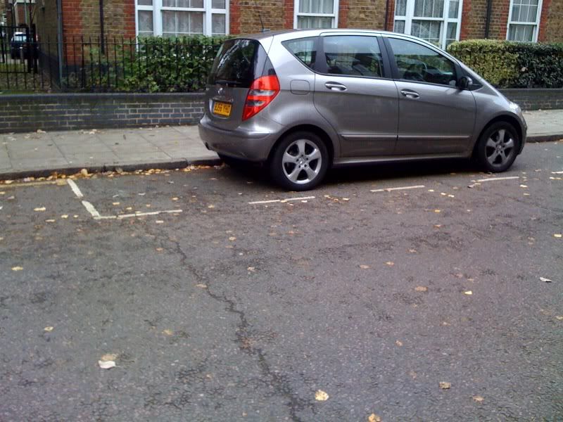

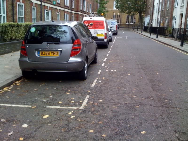

From the google map images the upright sign is compliant with diagram 661.3A, the bays are to diagram 1032, I can make out the correct double dashed end markings at the far end of the bay furthest from where you were parked, but the end markings nearest where you were parked are obscured by a car. Strangely if you move past the Werrington Street junction and look up the road at the bays google seems to use an older image showing bays to diagram 1028.4
Google Map showing 1032s
Google Map showing 1028.4
Can you confirm which image is correct as the bays are marked now, long single bay (1028.4) or divided bays (1032). If 1032s then what are the end markings at the Werrington Street end if you can remember?
I think that they are divided bays now. I am getting my friend to take some photos and send them to me.
Good stuff.
You have until the 31st to get the informal challenge in and still have them re-offer the discount if rejected, so there is a bit of time to play with at the moment.
I'll put the basic appeal together and we can add any issues with the bays if they crop up in the photographs.

Ok, that is a bay to diagram 1028.4, a picture of the end marking of the far end of the bay would have been nice but with those and the google map image we can assume it complies with TSRGD 2002.
I should have time at work tonight to write an appeal based on the other points, which you can submit tomorrow, using the web system or by fax to beat the 14 day deadline.
