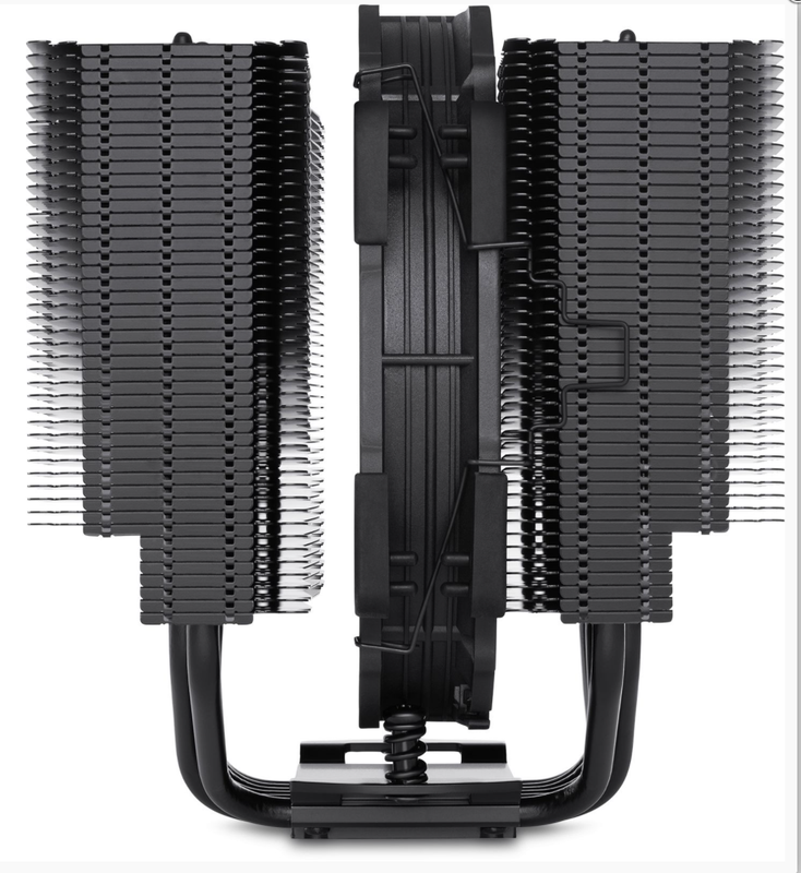

The D15S should have had a 30/35mm fan in its centre from the get go IMO.
