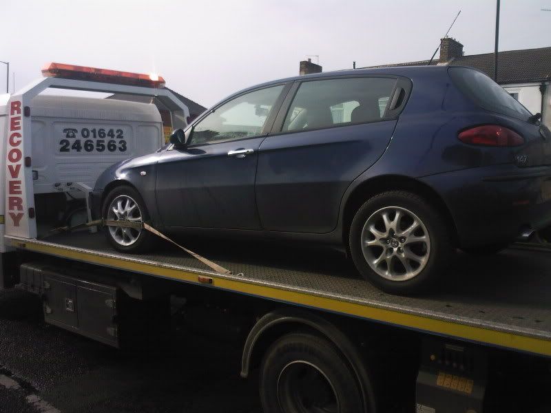

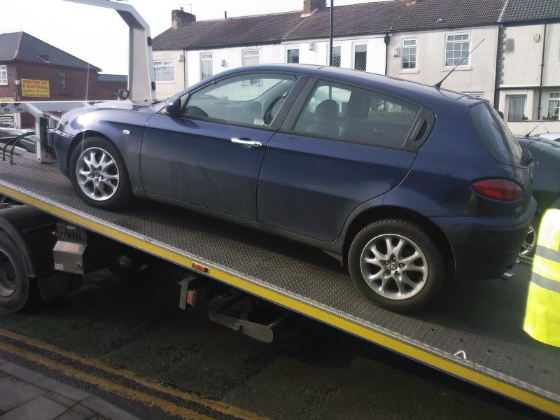

Thought I'd give you a laugh by showing you my 147 on a recovery truck;
Got it recovered to a local specialist, they have only had a chance to have a very quick look at it but the inlet manifold is blown apparently which could (hopefully not) be a result of timing belt failure. It shouldn't be as belts were changed less than 36k ago but you never know. I really hope it's not that as could be looking at 4 figures to repair which, tbh, probably isn't worth it.
