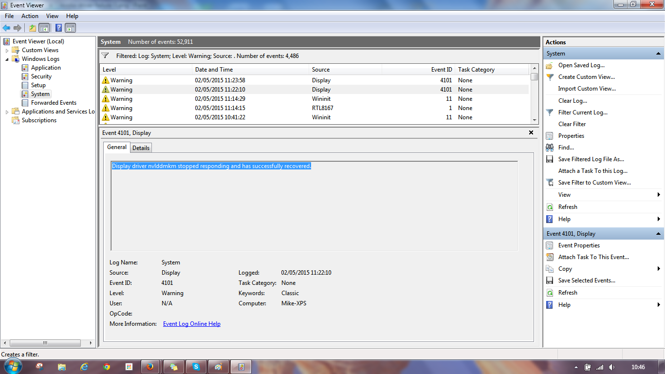

Anyway to specifically look for video driver crashes?
will look similiar to this.
anytime I've ever had issues with an Nvidia GPU (whether the card is just not working right, or an unstable overclock etc) it has produced these display driver crashes for me so it's worth looking for them in the event viewer to indicate something is wrong with the GPU
I've had 57 errors in the past 7 days for "Display driver nvlddmkm stopped responding and has successfully recovered."
