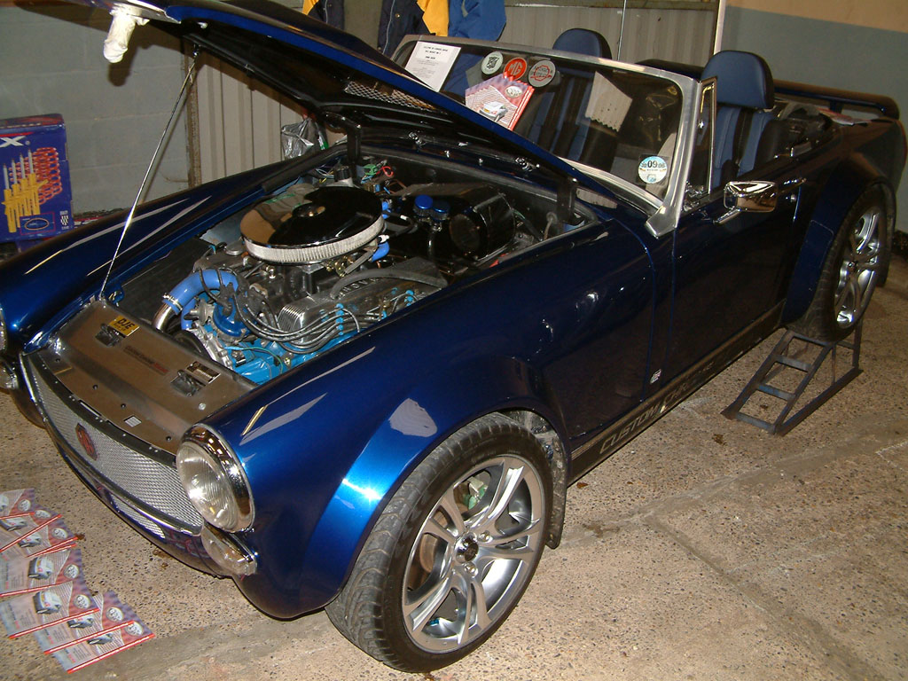

This is still one of my favorite classic project cars, MG midget with Rover V8 and Cosworth 4x4 running gear. Apart from the slightly naff spoiler at the back, this is what Rover should have made instead of the F.
Dogbreath said:
That was my first impression as well. No amount of fancy dampers can make up for an inherently duff suspension design...
They made the RV8...
